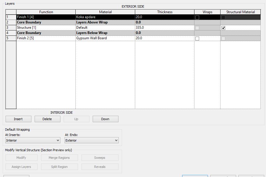

I have problem with Revit Arch. wall wrap..
Please see attached images.
Why exterior finish on top and bottom of the window insert is wrapping all the way ?
Is there any easy way to solve this without adding window sills ?
Thanks!
Sun, Aug 2, 2015 at 11:54:45 AM | Wall wrap problem
Wall wrap settings are jambs and ends of walls only.
If you want a sill material, add it to the family or in the model.
