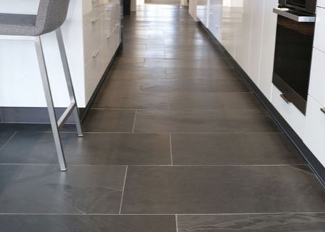

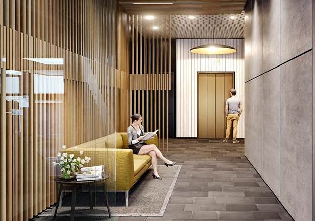

Hi all,
Ive been having a few issues trying to create a .pat file which shows our proposed tile layouts. I always struggle to get these .PAT files to work correctly.
If anyone could help, it would be much appreciated. They need to be model patterns (not drafting patterns).
  • The first pattern uses 2 tile sizes of 400x195mm & 195x195mm. The layout is as per the image attached titled Screenshot1 and the detail lines in the attached Revit 2015 file (Lobby Flooring Detail Lines).
  • The second pattern uses 1 tile size (either 605x400mm OR 810x400mm) with a stretcher bond type layout. Layout is as per attached image titled Screenshot2.
Much appreciated,
Kristian
