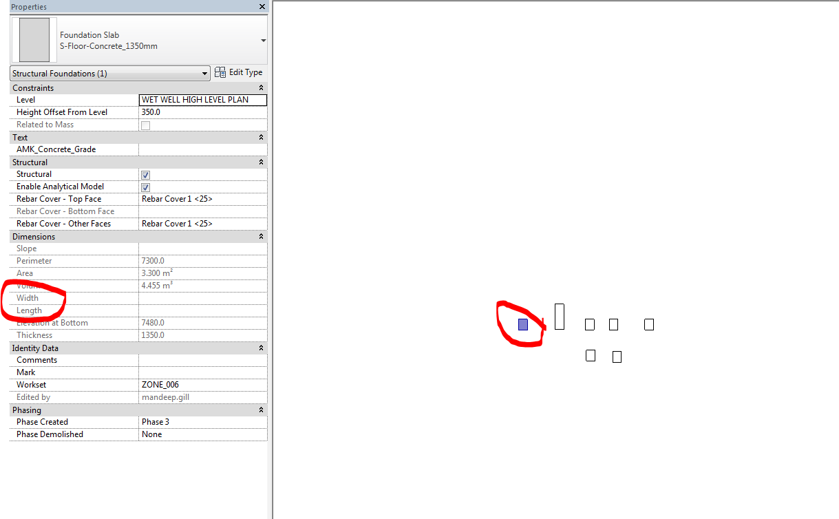

Please help! when i am trying to copy and paste a foundation slab the dimensions change, match properties does not work either it only works for changing type of family not parameters.

I am in a single project. the issue came about when I length and width parameters were empty for a foundation slab so I just deleted it and copied one which had the parameters and then I realised the instance parameters were not exactly the same I have tried this in both 3d and plan view.
i don't understand why parameters were empty as it was a system family and a simple cuboid with no voids.

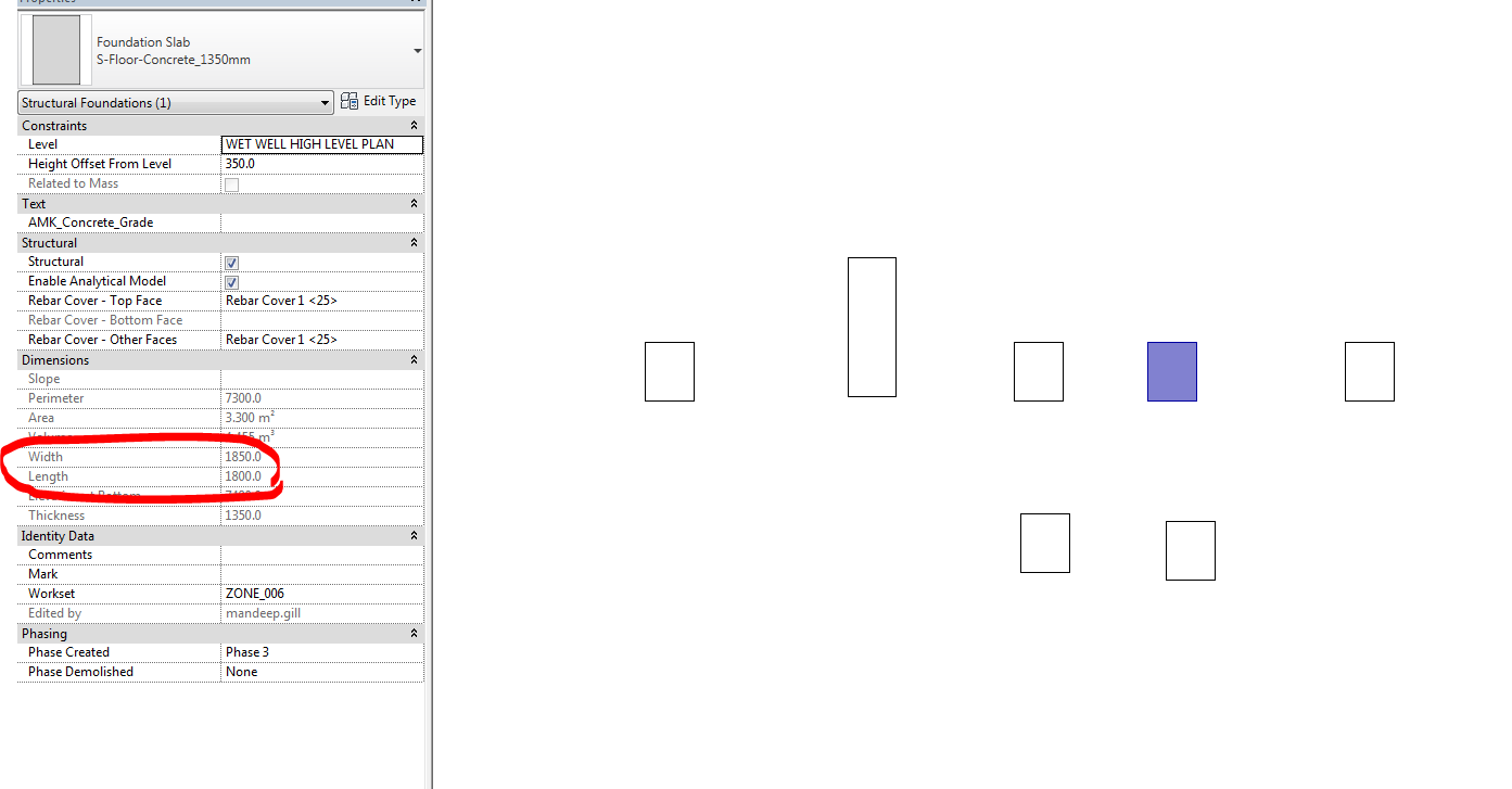

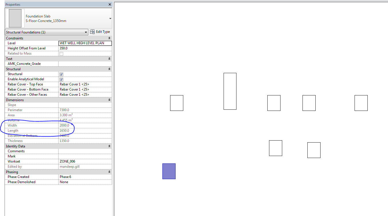

issues was in capture, so i deleted that slab, went to cap 2 because it had the parameters I wanted, copied it using CO command but in cap 3 properties are different.

Here is the point.   Copy and copy/paste both work and give you exact copies.  So someting is wrong with your process or possibly something else.
Match properties is: "Match Type Tool"  It does not match instance properties.   You can read about this in your HELP.
