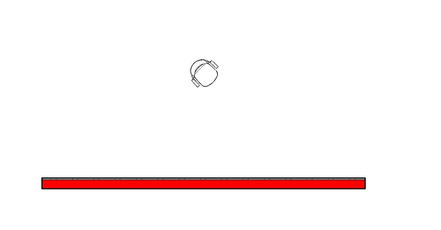

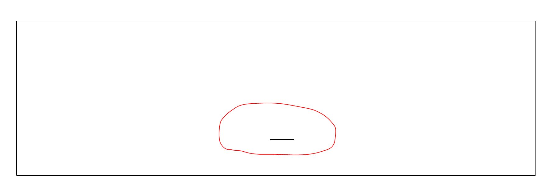

I have a chair family and for some reason a line of the seat is showing through a wall in elevation.  I know its coming from the seat of the chair but I don't know why.  Any ideas??

I’m not sure why this is happening, but it looks like these two splines in a void extrusion are causing the problem. Changing them to lines/arcs seems to fix the issue. There could be some other ways to deal with it, but I don’t have enough time to troubleshoot some more right now – sorry. Hope it helps ...some.

Thanks that got rid of it.  Weird that it would do that.
