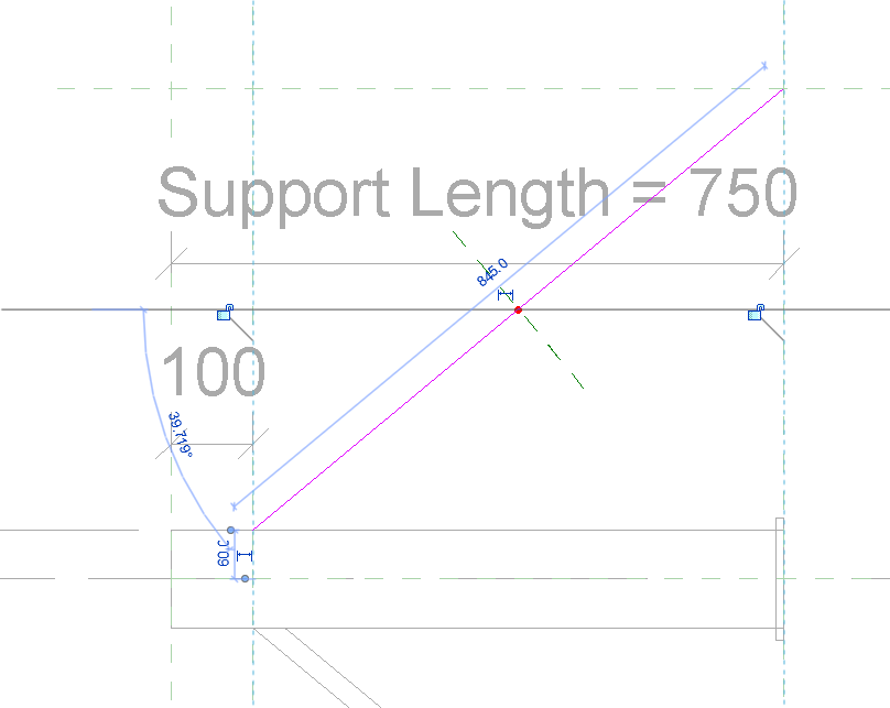

Hello,

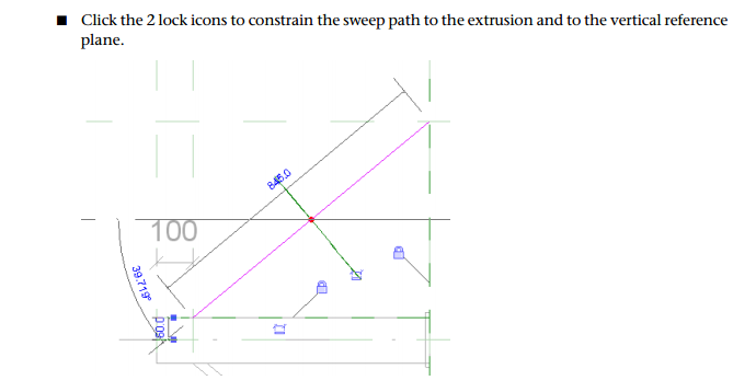

I have following problem: I've created support beam as shown in example of 'family guide' (http://knowledge.autodesk.com/support/revit-products/troubleshooting/caas/sfdcarticles/sfdcarticles/Autodesk-Revit-Architecture-Families-Guide.html) page 602.
Unfortunatelly I can't use padlock to lock my element made as a sweep extrusion in horizontal and vertrical way at same time. Could you please help me with that?
Please see attached: Revit family file, screenshot of family guide's page and screenshot from my Revit file.
Regards.

Use align tool. Pick a ref. plane and hover your mouse over the end of the path and tab until you get an end point, lock it. Repeat for the second RP.
