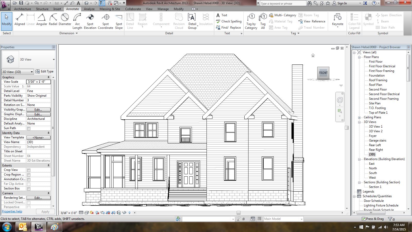

Does anyone know why the (3) 2x8 beam wont show in elevations but will in 3D?

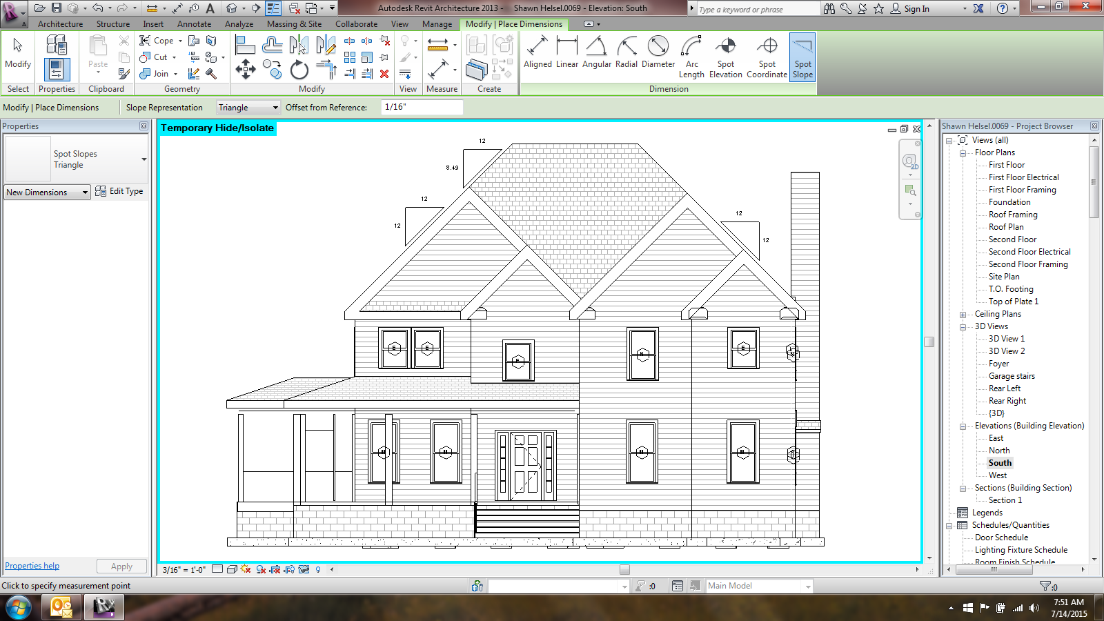

Also, anyone know why Spoy Slope seems to work fine on Gable roofs but not properly on Hip roofs?
Thirdly, does anyone know an easy to set up TWIN windows so they show properly in Schedules?
Thanks!
Gary

Sorry, ment to send these images

Spot slopes work correctly on hips... it is a process issue.  From an elevation, the first thing revit sees at a hip is the hip ridge slop.  Use yuour tab key to correctly pick the roof beyond.
Regarding the beam.   Is this a family you built?  Look at it's settings.  Otherwise look at your settings - both detail level and VG.

I was able to make the Spot Slope work by Tabbing through,
And found my detail level wrong (Dumb me Smile
