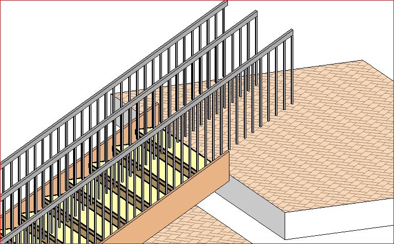

Dear experts:
Could you please help me to undrstand how to extend Railings beyond the first and last riser.
I mean NOT the top rail, but the railing path, i.e. WITH BALUSTERS. Please see the image: that's what I want, but I don't know how they did it.
When I edit the path, I don't forget to select each sketch line and to set a new host, and when the path exeeds the lower or upper riser, the whole railing does not follow the stair's slope. In the path property I have "By Host " selected for slope.
Please help.
Thank you.

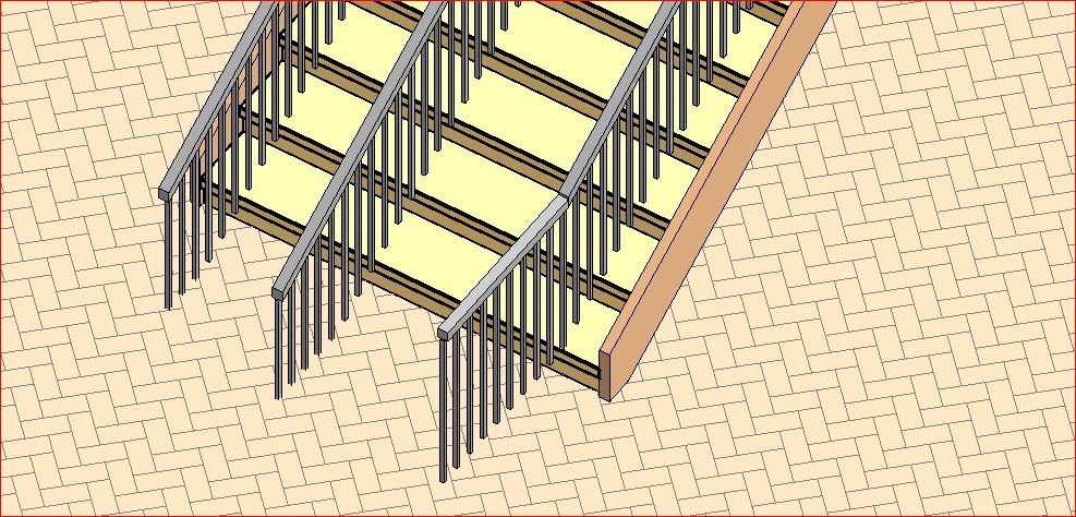

Hi CDWdavid;
thank you again for the link.
This is exactly what I am looking for.
However, can't still make it. I am still doing something wrong.
