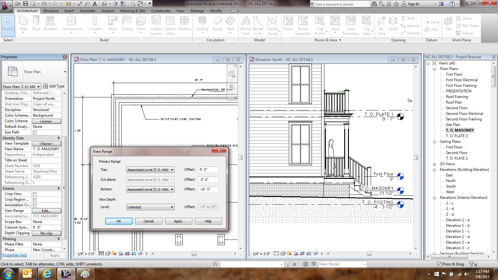

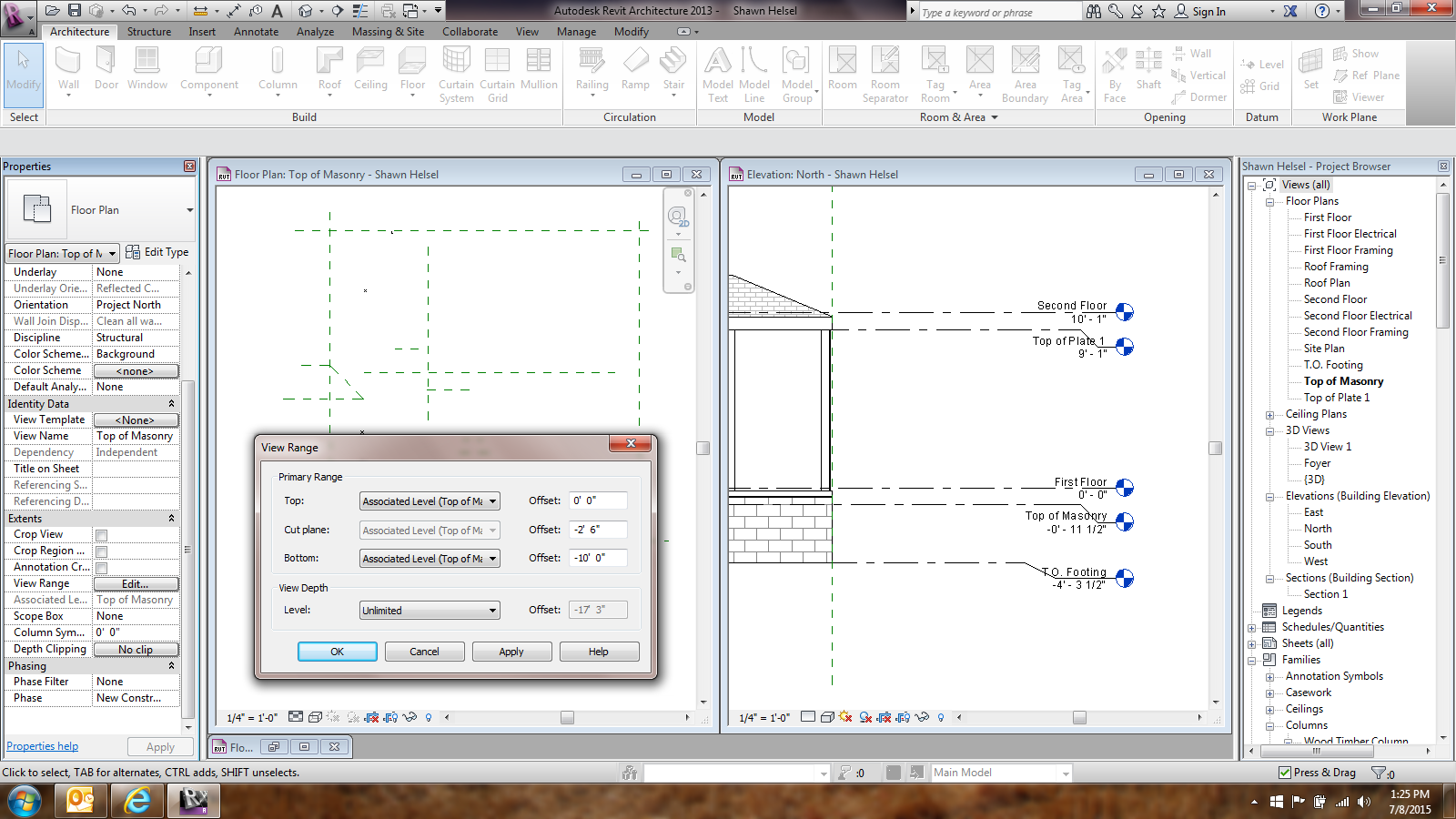

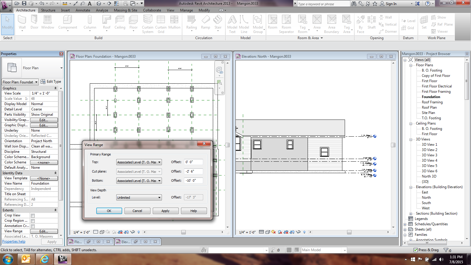

OK, I have attached 3 screenshots.
Can someone tell me why with the VICTORIAN, that the Foundation (Top of masonry) (That I was taught in Revit training class) shows all the details right down to the surface of the footing, but in the oter two, Addition only shows the piers and footing but no brick/block masonry wall. And the third Craftsman only shows the reference planes?
As you can see the View Range is set the same in all 3 and the top of masonry is at the same level in all 3.
I don't believe I have fooled with VG in any of them.
Can anyone see what I am doing wrong?
Thanks
Gary

You are copying views - don't do that!  Unless you really know what you are doing, always create your plans from the View/ Plan dropdown.
I see that all of these views may actually be RCP's because the possible underlay orientation is set to RCP.  In normal Plan views, this will be set to Plan.

Your discipline is set to Structural. If your walls are not structural, they will not show. Change the discipline to Coordination, or make sure your walls are structural.

WOW, Changing the foundation wall to Structural in the properties took care of it!
I never understood the difference, now I will always pick Strucural when promped?
Had never fooled with the Discipline before. Will now try it when problems arise.
