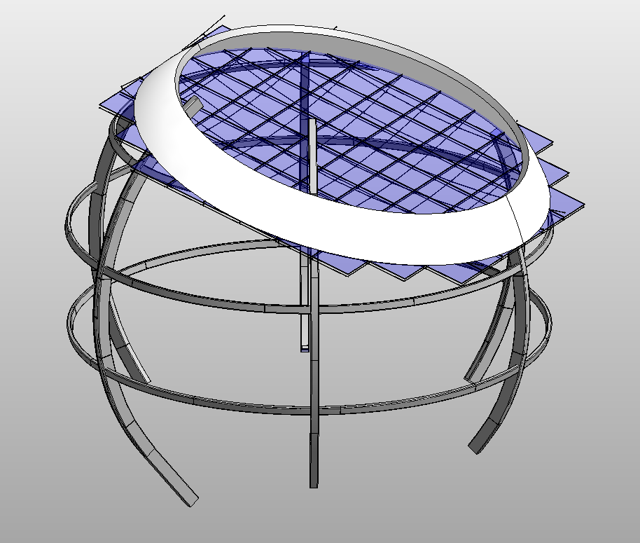

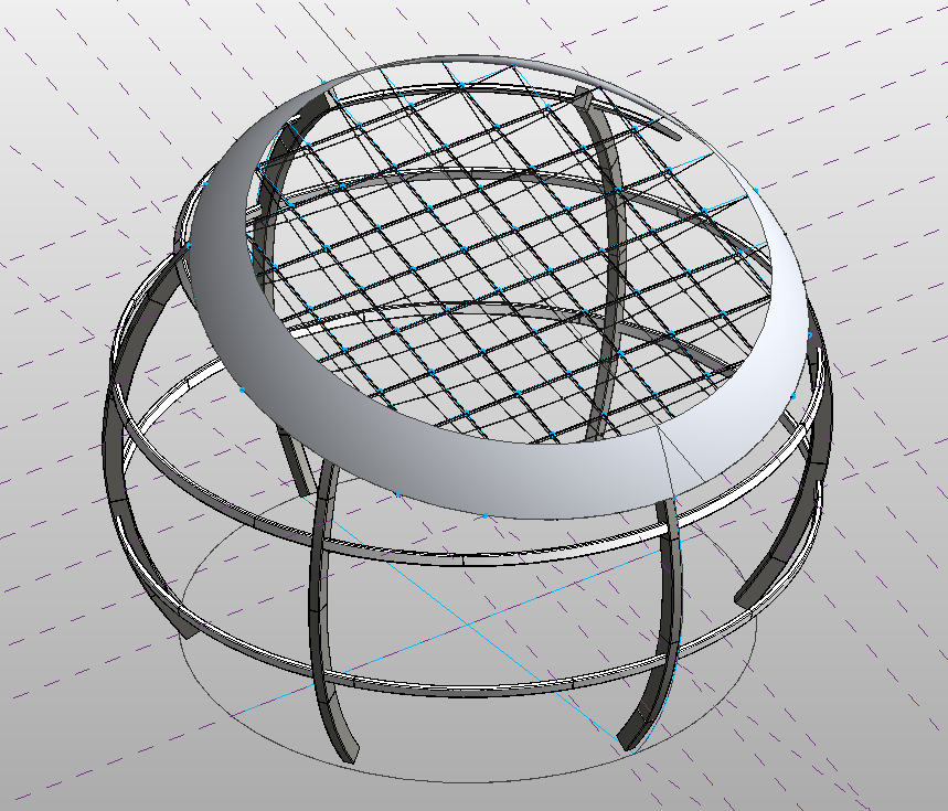

Hello,
I have a strange problem. I have created a mass with a pattern with a custom panel. In the mass environment all is nice and neat. If I load it in a Revit Project suddenly the pattern is not correct and I have some wrong geometrie in place.
Can someone explain what is wrong?
Thanks

OK, I think I have found the problem.I think the mass geometry is a little bit strange (I don't know, what crap do Revit) and the pattern can not apply correctly. I set the border tile to empty and now it is better.Revit is sometimes really Crap.
