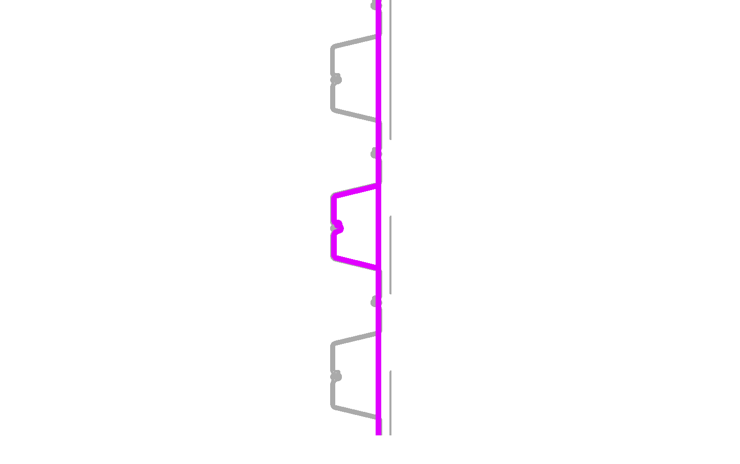

Im pretty new to revit.
And I need to get a floor to fin into sheet pile wall. I now got the sheet piles set us a wall using the array function.
Is there any way i can get the boundery of floor to follow the sheet piles or make the sheet piles cut into the floors boundary. Could i set the sheet piles up using something else than array to make it work? I cant do it manualy (1000+ sheet piles)

Do you really need to model these shapes?  Modeling items like this can potentially overload your project.
For metal panel siding, we don't model the shapes, we use a material.  The siding limits are shown as the typical interior/exterior wall lines of a singal material wall.  This is all you really need in plan views.  In detail views, you replace the wall with detail elements that show the profile.
