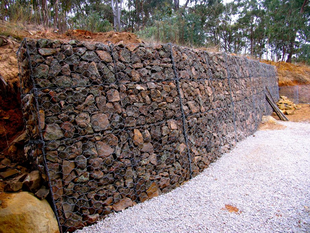

I'm trying to create a curved gabion wall,Is there is a way to created this kind of wall in revit?I tried the block family but I couldnt make it sloped to follow the drviway,any suggestion?

This is only a wall with a material.   Not sure where you will get the material.   Create an in-place family and assign the material.

That's work just fine!! but still have issue with the material for the wire around the stone,Do you have any sujjestion how to create this material,I did just the stone but I need the wire material to make it more realastic.

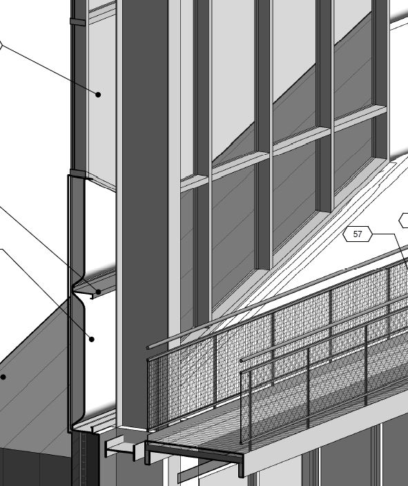

Thu, Jun 25, 2015 at 1:58:08 PM | Curved Gabion Wall
It might be in the material 'look' or maybe a thin wall on top of the stone.   Like the fence material I used in these railing panels.

You can look for a texture with a gabian wall and wire on top, and make it one material.
