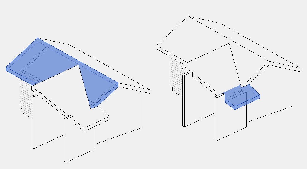

Hello.   Ater joining  two roof planes, some odd geometry appears. If I unjoin, it goes away.
How do I prevent this?   Or how do I get rid of it.

I'm assuming you did this in 2016 because I can't open it. Just looking at the images it looks like its a fascia, do you have a fascia put on the roof?

Thu, Jun 25, 2015 at 9:59:55 PM | roofs - extra geometry after joining
pijpiwo
pijpiwo Avatar
Joined: Fri, Sep 3, 2010
0 Posts
5 Stars: 25 Votes
You can divide your shed or gable roof – see pic.

User Menupijpiwo - thanks!
