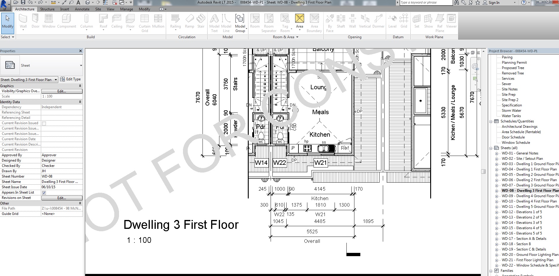

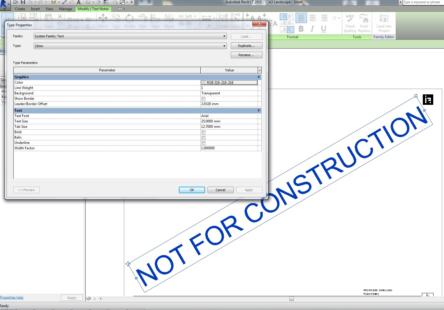

Hi Guys do you know how to make a watermark apprear behind the views placed on a sheet. I have the text on the A3 family page and set to translucent but it is covering the drawings see attached. Anyway of changing this?

Sorry that was in family editor.
Please see below of a view of the worksheet showing the text even though it is translucent, it is over the top of everything.
It only will go behind the windhow schedule. Goes over the top of plans and legends.
Edited on: Thu, Jun 18, 2015 at 7:18:01 PM
Revit 2018........
Fri, Jun 19, 2015 at 8:30:18 AM | Water mark not translucent
The translucent setting is only for the text background - not the text.   Sorry.

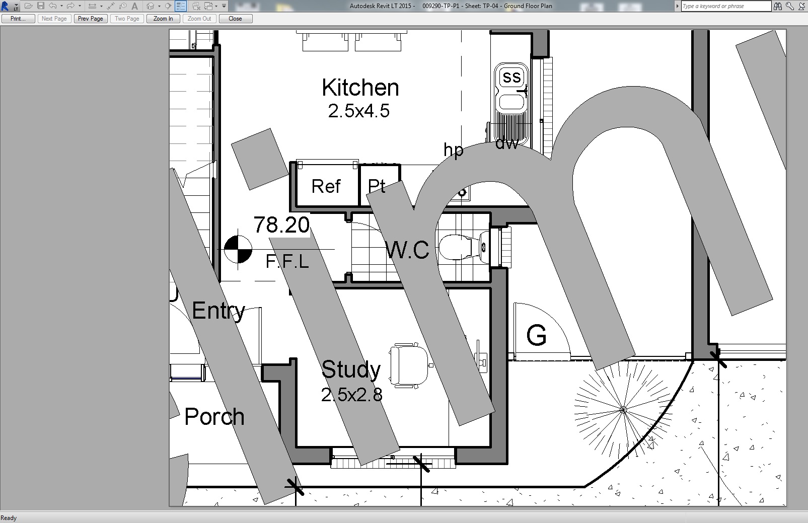

Hey WW hoping you or someone can help with this one.
I have drawn a preliminary legend using a translucent hatch (took a while)
It shows as it should in plan but when I print or pdf it goes over the top.
In print setup it is on colour even when I change it they all end up the same.
Revit 2018........

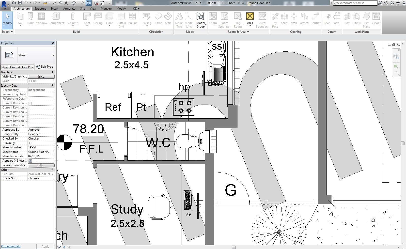

See this. I have never tried Steve’s suggestion though. I’m still using Acrobat for that.

I tried that one and got this result. :-(
I ended up making it a fill region and putting it on individually....
