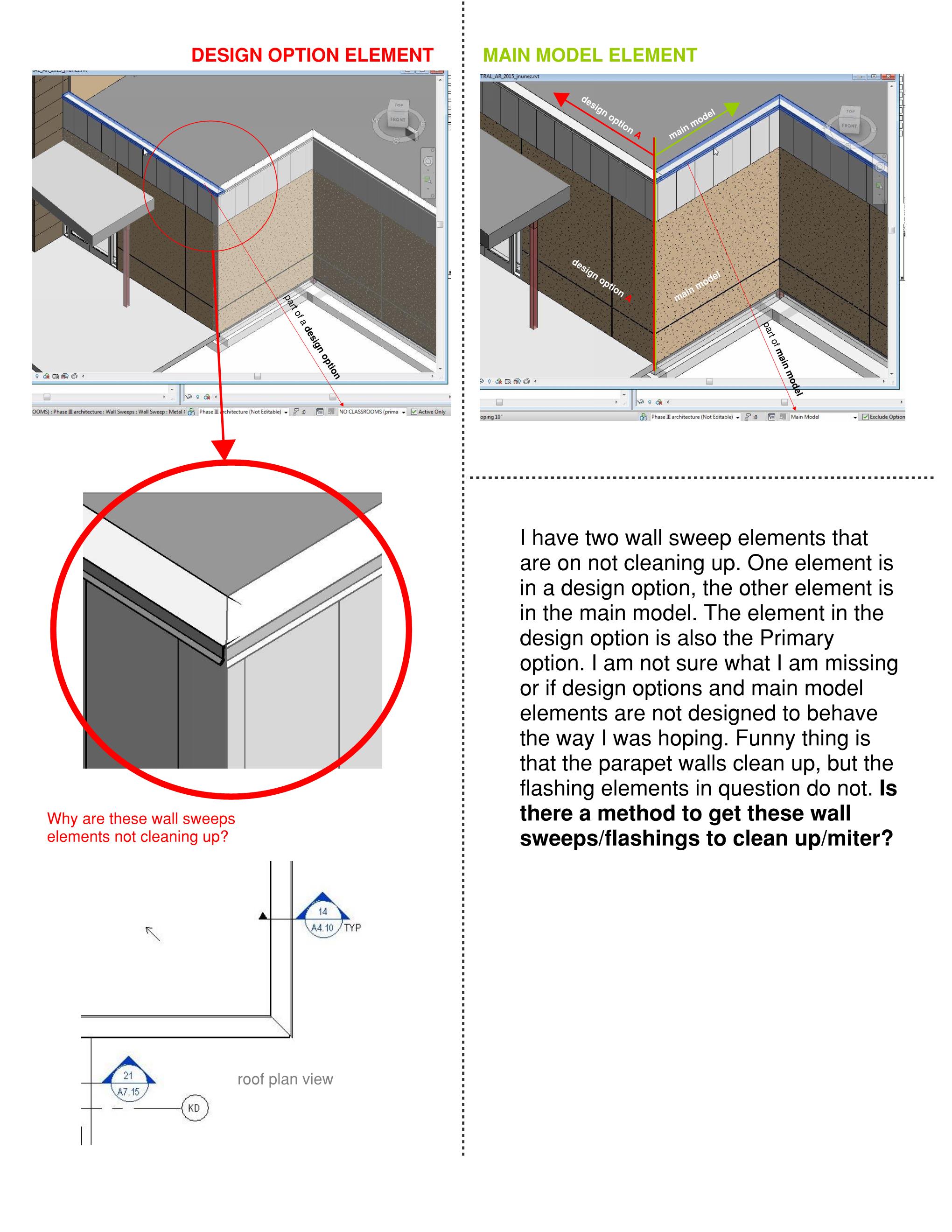

I have two wall sweep elements that are on not cleaning up. One element is in a design option, the other element is in the main model. The element in the design option is also the Primary option. I am not sure what I am missing or if design options and main model elements are not designed to behave the way I was hoping. Funny thing is that the parapet walls clean up, but the flashing elements in question do not. Is there a method to get these wall sweeps/flashings to clean up/miter? See Attachment.

Try doing them as 2 different sweeps and see if they will clean up

teafoe5, I think I understood what you were suggesting and I separated wall sweeps into separate elements, but am still getting weird overlap and not the clean join. See Attachment.

Sweeps only clean up correctly when they are placed in one operation.  Seperate sweeps can only overlap.   But the overlapped sweep can have a 90 degree return which can look correct.
Below are three return settings.   One at 90, one at 135 and one at 90 an pulled over the end of the wall.

WWHub, that did it! Thanks.
