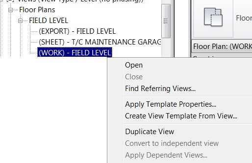

Whenever I apply a View Template to Dependent 2 in the attached pic, it updates Dependent 1 and the main view as well and vice versa.
I have seen a similar Project Browser organization where one did not effect the other, even though they appeared as dependents.
How can I achieve this?

I understand Dependent Views, but how was this achieved? (see attached)
The (EXPORT)(SHEET)and (WORK) all appear to be dependent views, but "Convert to independent view" is grayed out when I right-click.
Furthermore, I am able to apply a different View Template to each of them separately.
Whenever I attempt to make my dependent views independent, it moves the view to the main category. This will get cluttered and confusing as the project progresses.

My apologies about being confusing.
The 2nd pic I posted was from the Architect's model. They seem to defy the laws of Revit by making their (what looks like) dependent views as independent. This is what I want to achieve.
I have emailed them the question, but they have left for the day so hopefully I will find out tomorrow. The suspense is killing me Winking

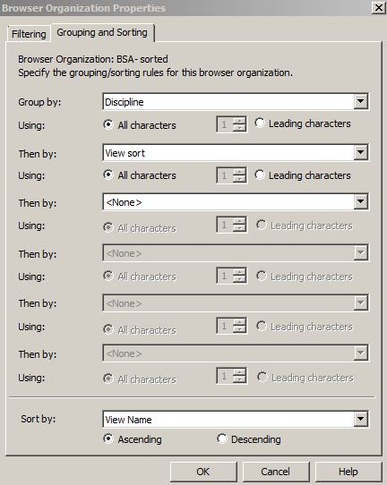

Did you know you can set up your browser with sub folders?
You want to do the following in your template for future and in your current project since you have already started.
Add a new shared parameter to your shared parameter file.  We called ours simply 'View Sort'.   Under the manage tab/project parameters - assign that shared parameter to views.   Now set up your browser sort to sort your views using that parameter.  AND!!! This parameter is now available in all of your views and view templates.  So assign it!   For instance in our hotels, we have a folder called Guestroom Elevations ... one for the stairs -plans/sections details... likewise for Public Space items.... Whatever fits your work.

I must be getting better at Revit because I was able to do what you wrote.
It needs some tweaking, but it worked.
Thanks, WWHub.

I heard back from the Architect. They organized their browser just as you described with browser organization WWHub.
Mystery solved. Thanks again.
