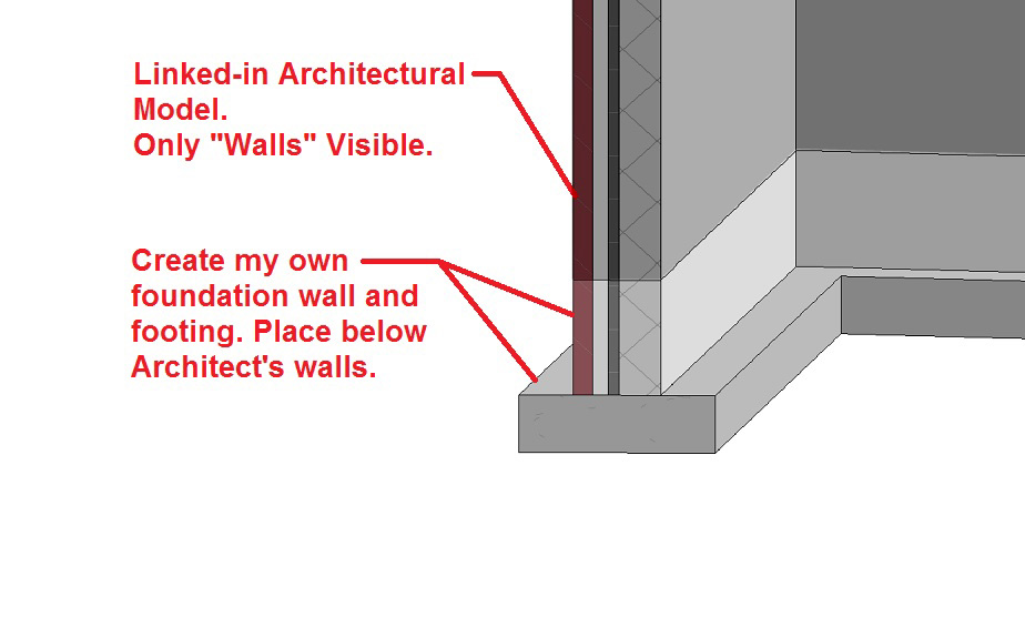

Problem: Using Copy/Monitor to bring in walls from Architect's model has been a nightmare. Walls don't join properly, exterior/interior is flipped at times, they have custom insets & reveals that do not transfer via copy/monitor, ETC.
Question: Would it be bad practice for me to simply link in the Architect's model, turn all visibility off except walls, then place my Structural foundations and framing on those walls? (See attached pic)
One disadvantage is that I cannot lock/constrain anything to the linked walls.
Your thoughts please.

There is no reason to copy walls that don't affect your structure.  In most cases, architectural reveals or inserts should not affect you.
You do know that when you copy/monitor, you can assign your own types to the walls that are copied into your model?  In most cases, you are only concerned with the structural portion of the walls.

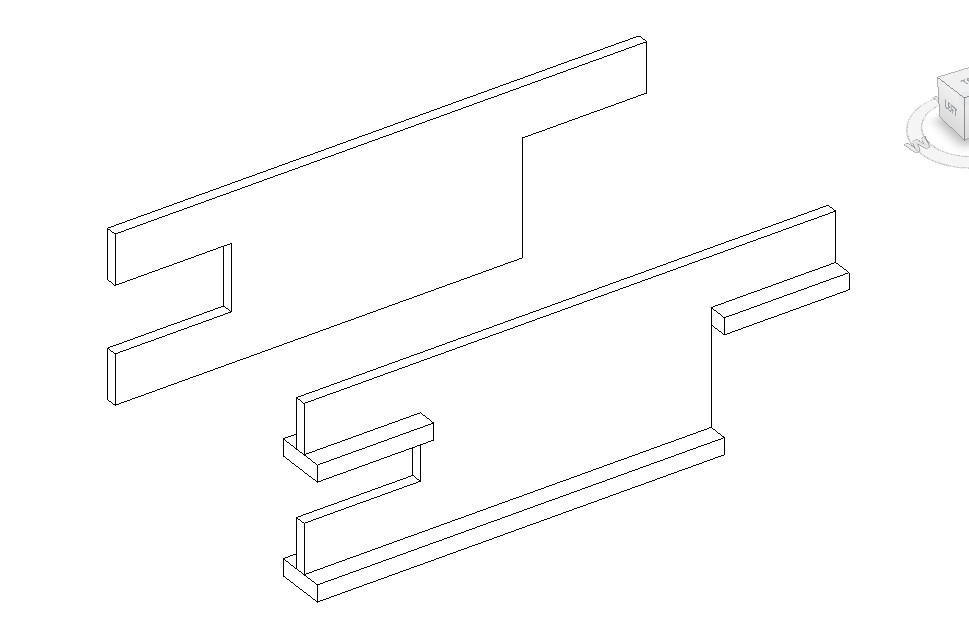

If the wall has an edited profile, I get footings underneath all parts (see attached).
I assume the work-around is to use wall & door openings instead of editing the wall profile? If so editing a wall's profile seems pointless for a structural engineer.

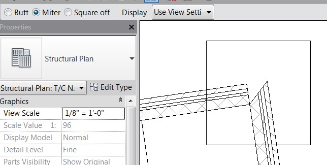

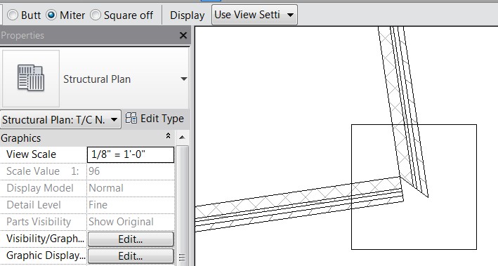

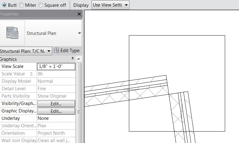

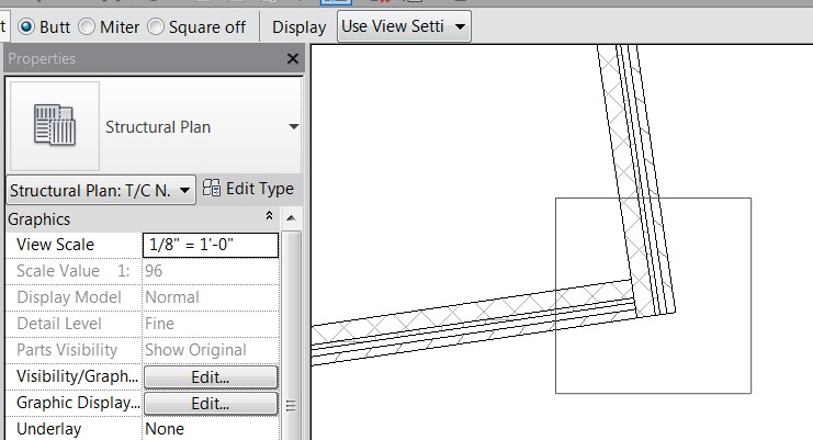

How come one end of this wall butts correctly, but the other end does not? Could it be the wall not cooperating has an edited profile?
The other pics are what the same corners look like Mitered)

Your architect may not be doing you any favors....I pay a lot of attention to wall joins and I work with our structural engineers.
Wall sketches are always problematic.  So are unlocked layers.  Autodesk needs to change footings so they are not affected by finish and substrate layers.
The image with the stepped - weird footings on the sketched wall could be handled with split walls (vertically).  That should be done where the wall forms a 'C'.  The upper portion should be seperate and not have a ftg.  The step on the left is OK except for too big of a jump.  I handle jumps like I post here:  http://www.revitcity.com/forums.php?action=viewthread&thread_id=34557
The last set of images may clear up if you step through the joins available although the ones to the far right may be cause by wall join conditions above.  Look in 3D.  The walls need to be at the same level.  If not, then a horizontal split may be required.

I think most of your problems could be alieviated by using seperate foundation walls.  Unless we have lower (basement) levels, our architectural walls end at the first (ground) floor level.  The structural engineer places his own foundation walls under these walls.  He copy monitors interior structural walls and openings using his own core only walls.   We link his model back in and only show his foundation walls.  That seems to work well for both of us.

That was also my thoughts at the beginning of this thread.
Most of the walls will be CMU/Brick, with sloped Bar Joists bearing on them, plus CMU/Brick parapet above. I suppose I will need to show my own walls so that things will display properly on my plan sheets.
