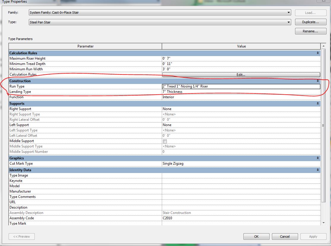

Is there a way to apply carpet or vinyl materials to treads, risers and landings?

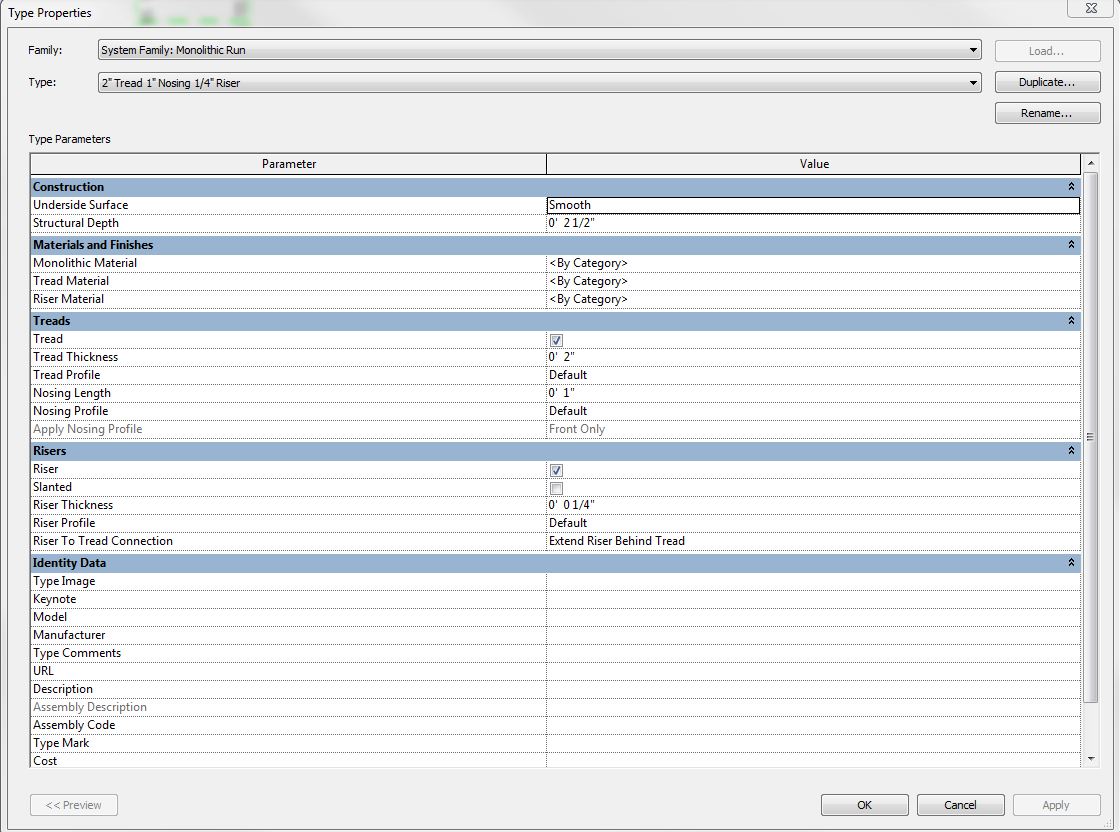

Click on your Stair>Edit Type then under Construction click on your Run Type and you can change the materials in there.
