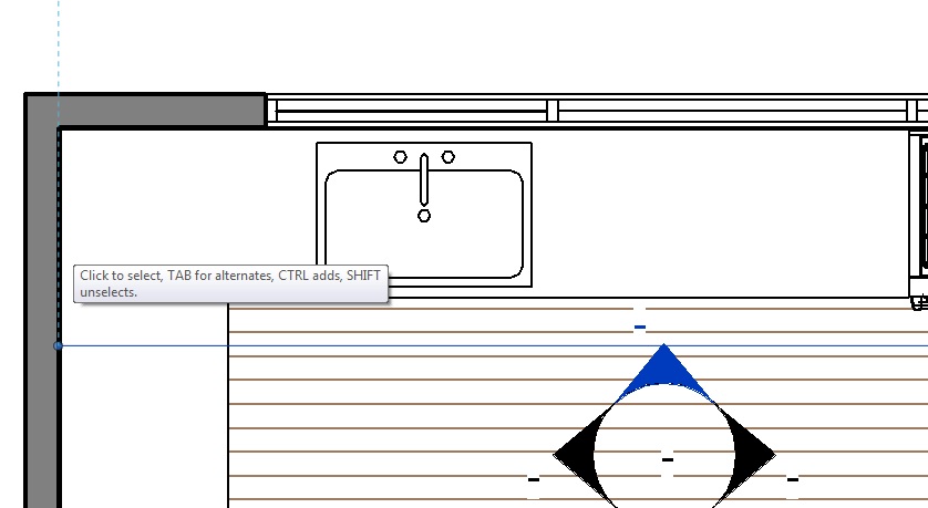

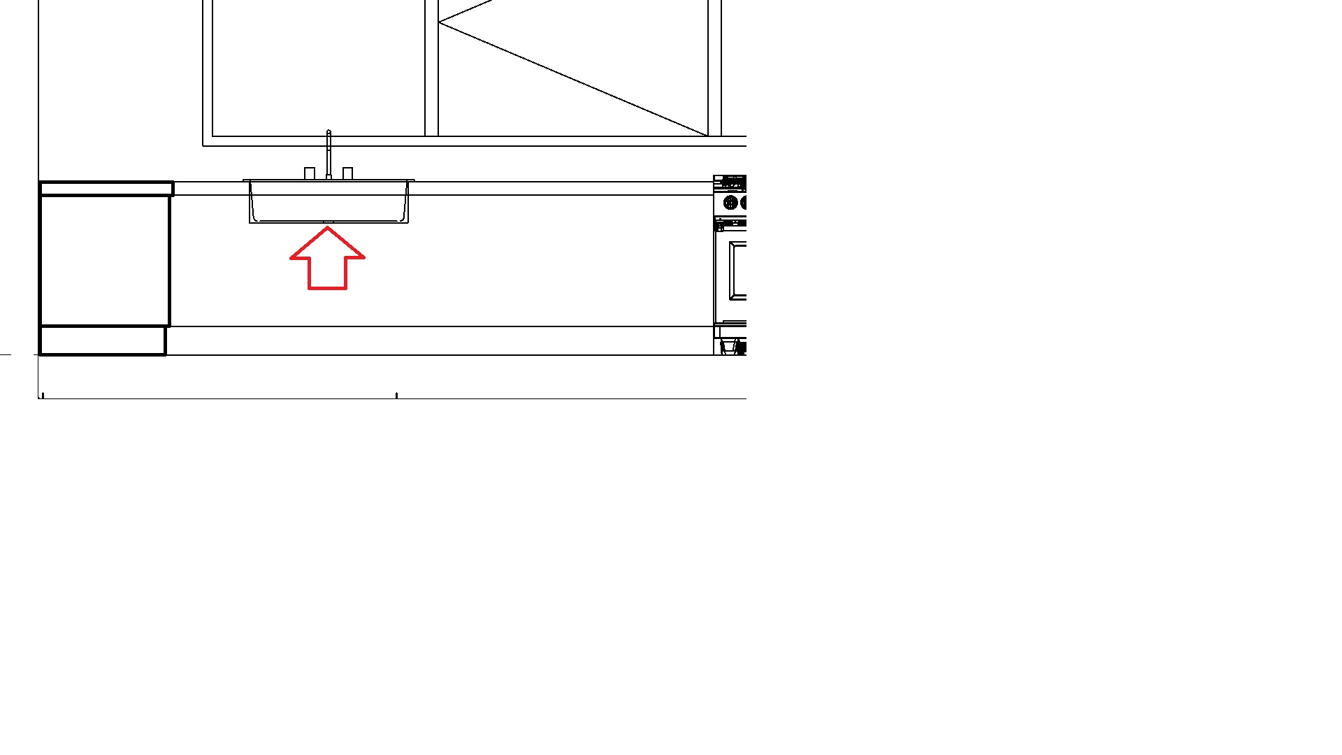

In revit 2013, I am starting to model kitchen cabinets as in-place components.  It's fine in plan but in elevation the sink shows through the cabinet extrusions.  The elevation cut line is in front of the cabinet.  See attached images.  The red arrow points to the lines of the sink that should be hidden.  I imagine it's a problem with the sink family, but I can't find it.  Any suggestions would be much appreciated.

The elevation is in hidden line view, btw.
Thu, May 21, 2015 at 7:24:16 AM | Sink family showing through extrusion in elevation
If it shows, the it probably cuts the base cabinet.   Cut a section through the family and look at it.   BTW - There has always been pretty good cabinets already available with Revit - look on autodesk seek.

It doesn't cut the base cabinet.  I altered the family so the base of the sink isn't visible.  Thanks.
