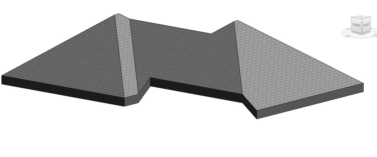

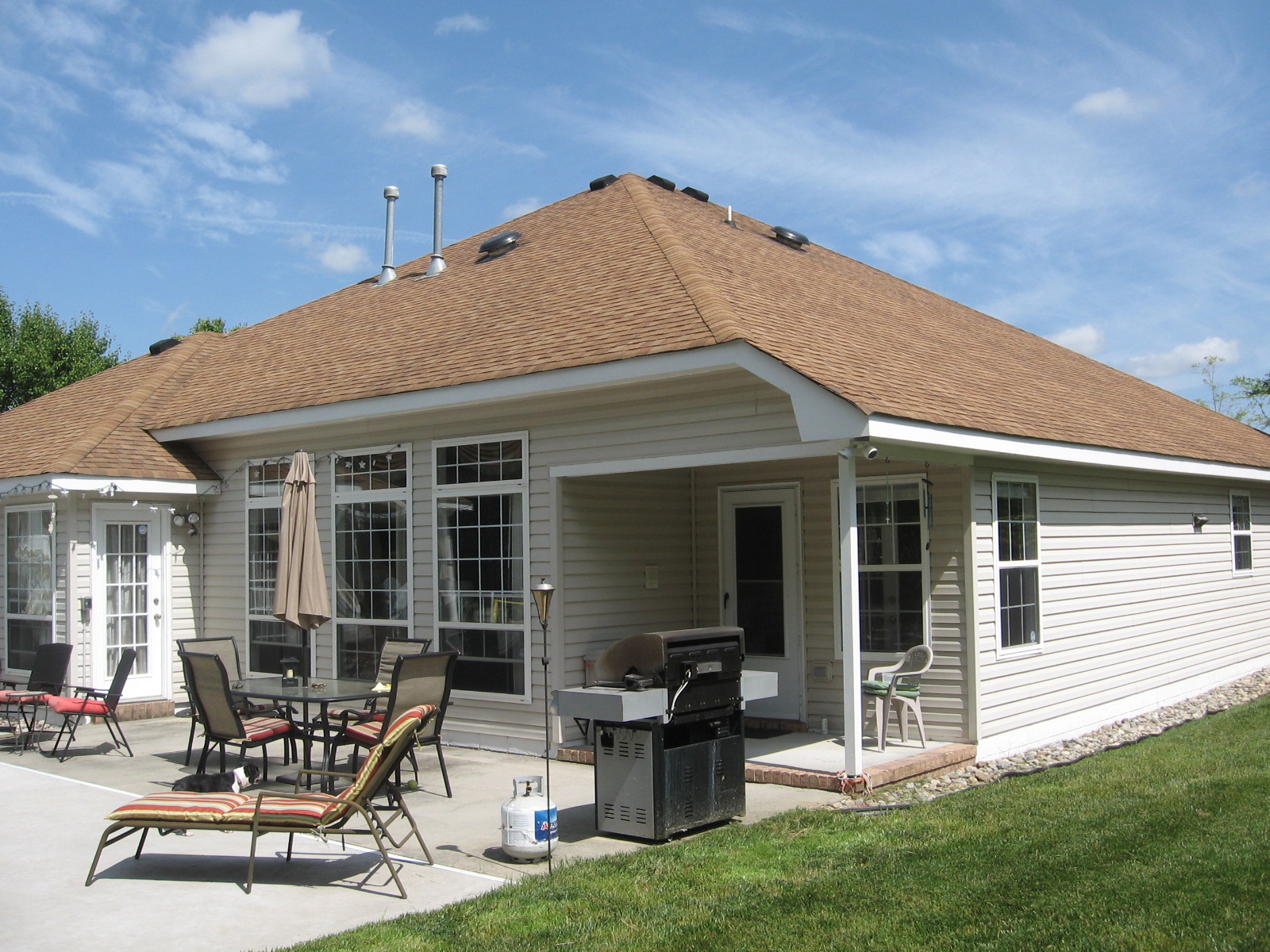

In consideration to adding an addition to this area of this house, I first need to draw the existing roof. I have tried different ways but no sucess.
Does anyone have any ideas?
Thanks,
Gary
I am using 2013
Fri, May 15, 2015 at 9:27:58 AM | Can't figure how to make this roof
This roof is basically one roof.   There would need to be an additional small roof where the low roof in the front extends under the high roof.   Look at the attached.   To get the bump up eave just set the height for that one sketch line as I have done.

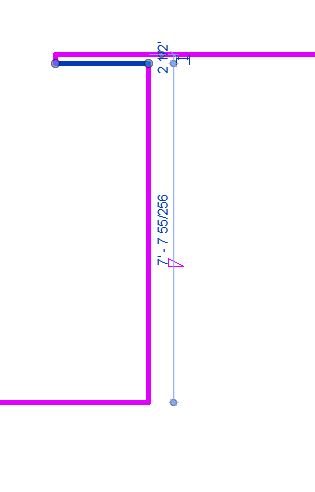

OOPS - I missed the high roof extending over the low roof.   Fixed that by adding two lines.   The small one (shown as 2 1/2" here for clarity) should be as small as revit allows you to do.
Fri, May 15, 2015 at 9:54:08 AM | Can't figure how to make this roof
Your process is somehow incorrect - look at the line's properties in my image.

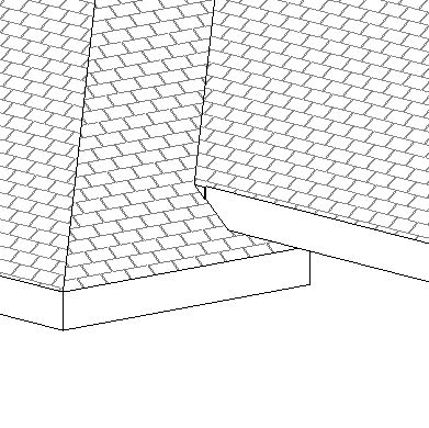

Here is my final roof with the little roof underneath and joined to the main low roof.

That little return (2 line area) may be too deep.   It can't reach the hip.   Adjust the little line moving it to the right.   You may have to play with this awhile to get it right.

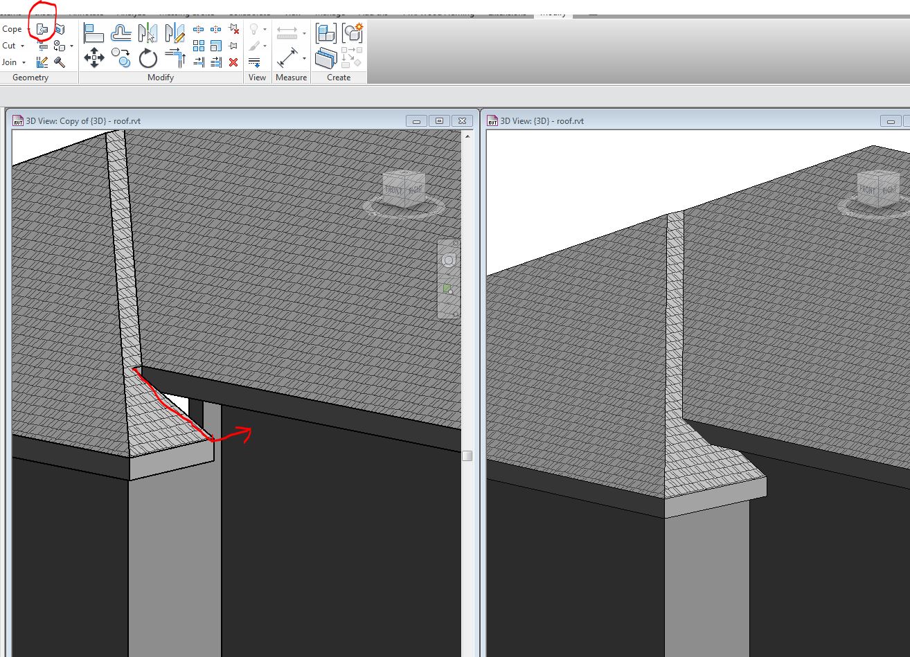

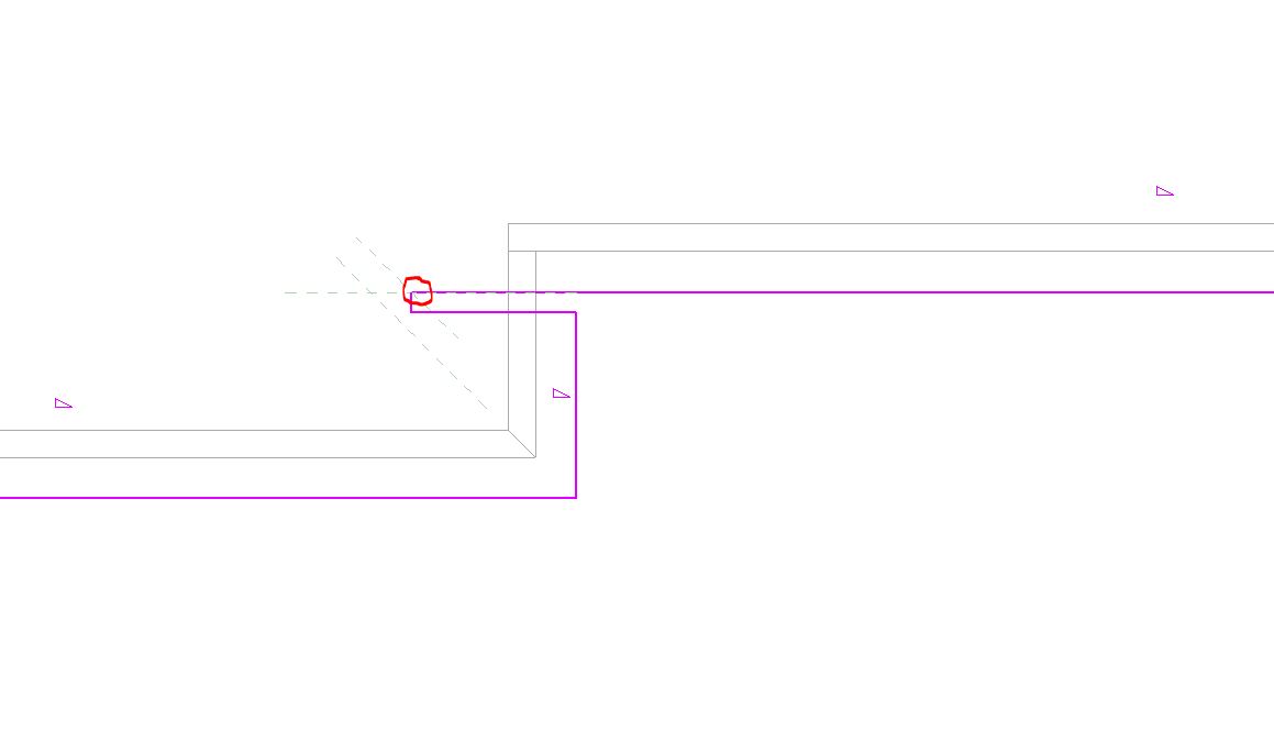

To take WW’s suggestion even further, bring this little line to the point of eave and roof intersection (pic 1) and use Join Roof tool to extend lower roof to the wall (pic 2).
