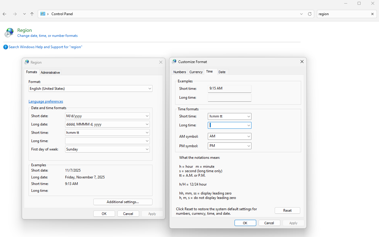

Just found this on the Revit forum, using the default revit timestamp, no Python or Dynamo
https://forums.autodesk.com/t5/revit-architecture-forum/date-stamp/td-p/12572492
This way is even better, becuase you don't have the . at the end:
Go to old school control panel, type region (should say Change date, time, or number formats)
Click addtional settings... navigate to "Time" tab, in the Long time: use this unicode (U+202F, " "), just the text betweeen the quotes
Works perfectly
