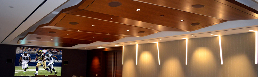

I have to creaat cloud ceiling,please see the attachments.I wonder if any have try to create the same kind og this ceiling?
I tried model in place,but can't get the same shape .any ideas?

Just use an actual ceilings with slopes. Each panel will be an individual ceiling.

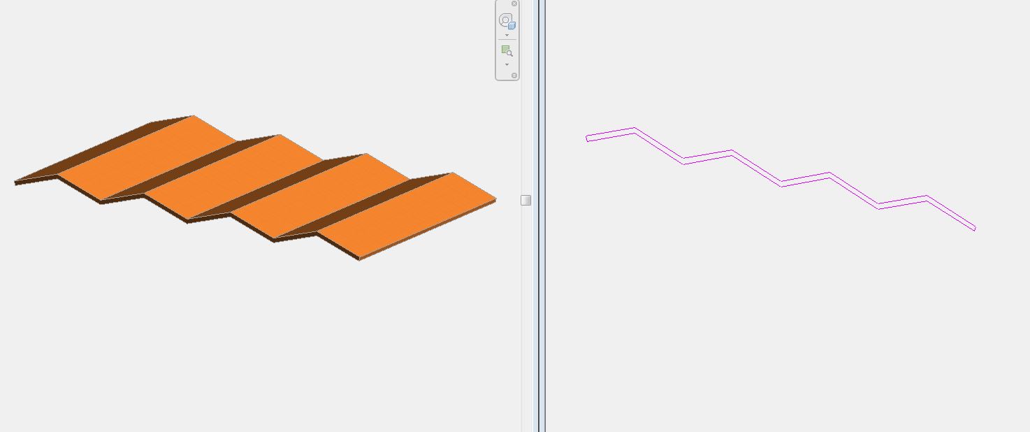

If I’m reading the picture correctly, it looks like a straightforward extrusion – model in place, ceiling category.

Yes!! That what I did,and worked just perfect
