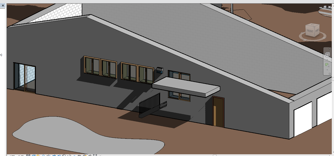

Hello, as you see in the picture, i am trying to add in a deck with stairs up to it and i will not let me move the floor up of down from floor to floor. i need it under the sliding door but it wont let me put it there. Not on the 1st floor or second or site. i tried ceiling of 1st and that didnt work. its odd because it is a multi level house and the floors are not normal height and it adds it in the middle of the door. any help would be nice. thank you.

also, sorry im new to revvit, and can someone tell me also hopw to remove the shading from the house? it annoys me lol
Tue, May 12, 2015 at 2:54:24 PM | Revvit 2016 porch/deck height help please
I assume this is a floor - correct.   Click on it and under properties, set the corect height up/down from the reference level it was created from.

JEEEZ, I WAS IN THE PROPERTIES TOO, THANK YOU SO MUCH I WAS GETTING A HEADACHE
