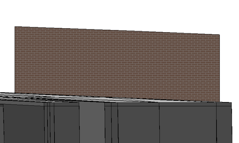

Hey, I think I found a cheap way to do something like this. Instead of modelling the toposurface, you create a floor and modify it using slab edges to match the topography. Then you are able to attach the wall to this floor, and are able to draw lines on the bottom of the wall which follow the slope. You can then offset any distance from these lines, which makes the wall always a certain distance above the slope. Hope this helps
