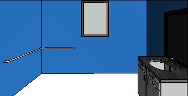

I am trying to create a perspective of a bathroom but the plumbing (i.e. sink, bathtub and toilet) are not visible in anything but the floor plan.  I've checked for filters and hidden elements and components, the visibility graphics, graphics display, view template, etc. to no avail.  Does anyone know how to fix this issue?  It's an issue in all my bathrooms.  Thank you for your help.

this might be just detail item component? NO? then maybe,
if someone created this family for you or you have just downloaded those family, you might want to investigate if the 3d form is visible in 3d views..
based on your plan, the lines are so clean... and the creator of this family (might) have hid the 3d form in plan view. and so in the 3d view.
