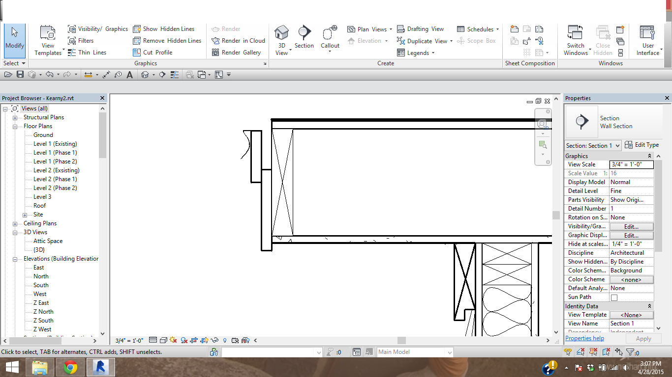

I would like to extend the 1/2 inch plywood and ashpalt shingle layer out past the soffit detail. How would you go about doing this?
Tue, Apr 28, 2015 at 3:08:55 PM | Wall section question
There is currently no easy way to do this with the normal model.   You could do 2 roofs but that seems to be a waste.  Typically, we just use the edit cut profile tool to cut back the structure and leave the plywood and shingle layer out.
In your case with the stepped fascia, I might cosider using an in-place void sweep to cut the model roof.
Tue, Apr 28, 2015 at 3:12:40 PM | Wall section question
coastalclimbing
Joined: Sun, Nov 23, 2014
0 Posts
5 Stars: 1 Votes
I tried the cut profile, however the line weight was thicker thant that of the roof materials. How would I go about changing that?
Tue, Apr 28, 2015 at 3:29:21 PM | Wall section question
I have been complaining for years that this is not an independent setting.
You have to change the cut-lineweight of the category then use the linework tool to bring your other lines back up.
Tue, Apr 28, 2015 at 3:58:47 PM | Wall section question
coastalclimbing
0 Posts
5 Stars: 1 Votes
Wow, thanks for the suggestions! The couple months I have been using this program I am amazed how thorough Revit can be and also how simple and basic tools have been left out. I think I will actually create a second roof and manually stack them so that the material show up in my materials takeoff.  O well another workaround.
