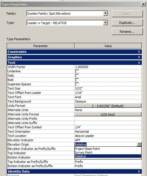

I have an RCP where the deck above is being exposed and would just be skim coated, but I want to note the height. I can't use the ceiling tag because there's no ceiling there to tag and I can't use spot elevation because it's a multi-story project. I should just be using a symbol, but I can't figure out how to upload that symbol to my project. It should be in the imperial library right? Any ideas? Thanks.
Tue, Apr 28, 2015 at 10:01:05 AM | Need the nonactive level symbol
Multi-story has nothing to do with a spot elevation tag.
If you mean you don't want a real elevation then create your own target symbol if need be.
Tue, Apr 28, 2015 at 10:09:55 AM | Need the nonactive level symbol
missjessica10
Joined: Mon, Aug 18, 2014
0 Posts
Well, the spot elevation gives me like 200', but right that doesn't give me ceiling heights. I was hoping a symbol would be already created in the program since it's a standard symbol and I wanted to avoid creating one.
Tue, Apr 28, 2015 at 10:14:46 AM | Need the nonactive level symbol

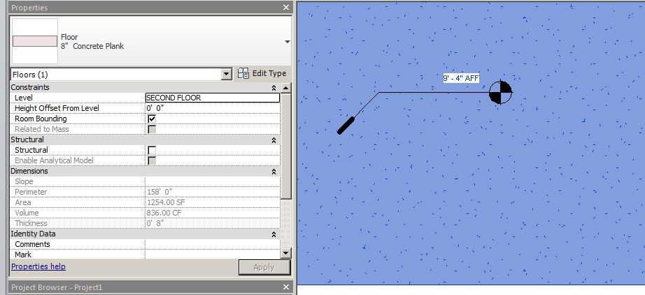

Spot elevation tag types can be created that are relative to the level.  Why use a DUMB tag when it can be SMART?
Tue, Apr 28, 2015 at 10:18:29 AM | Need the nonactive level symbol
missjessica10
0 Posts
Because I need to tag a ceiling height and there isn't a ceiling there. It's exposed to the deck above.
Tue, Apr 28, 2015 at 10:41:37 AM | Need the nonactive level symbol
Maybe I'm just being dense but I can spot elevate the bottom of my deck.  I would assume that that is the elevation you want or do you want the bottom of the 'skim'coat?  My PC deck is at 10' AFF and this is my RCP.
