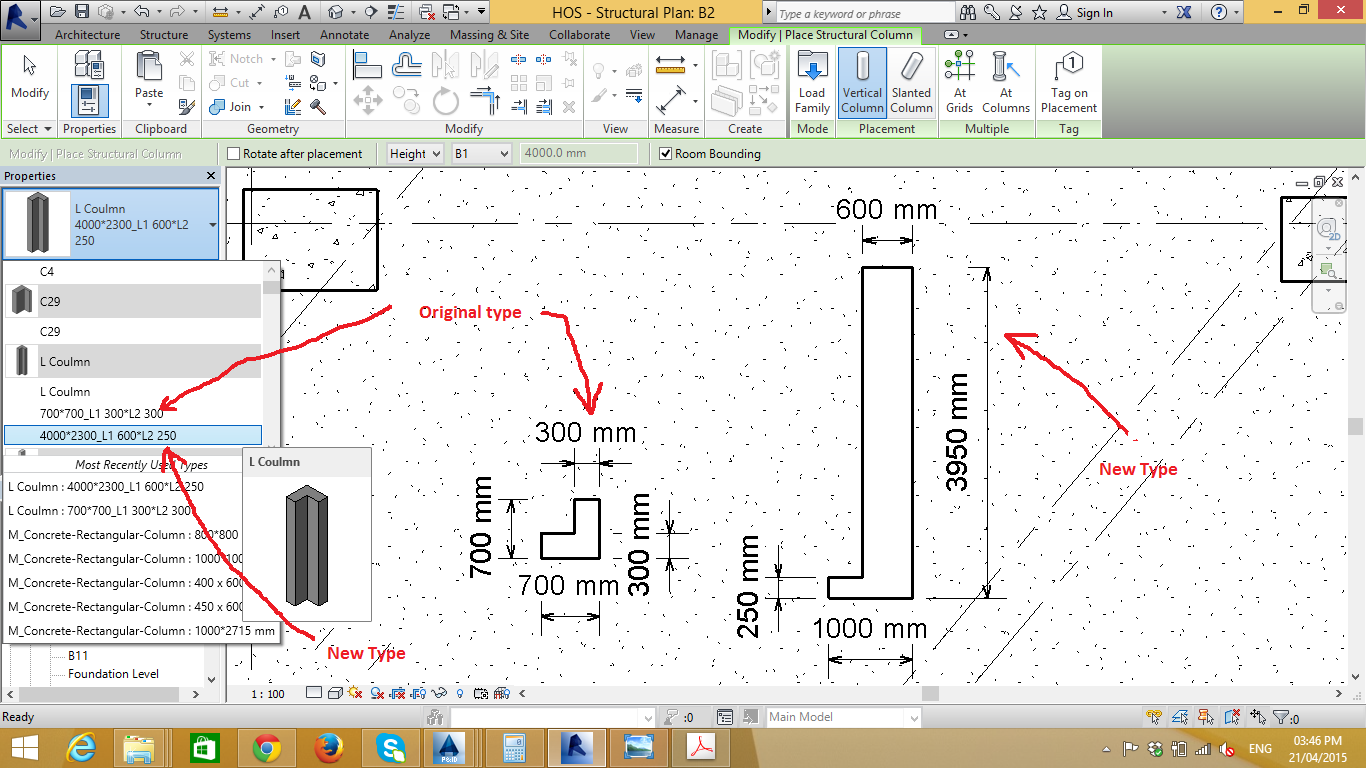

I have created L-column family with depth and width 700mm and with thickness 300mm. I added parameters for all its dimensions and loaded it into the project.. everything is alright till this moment. I wanted another L-column with different dimensions so I just duplicate the old type and changed the dimensions. the column placed with dimensions that differs from what I had input and from the original dimensions as well!!! Any ideas??!!!!!

this is the situation!!!

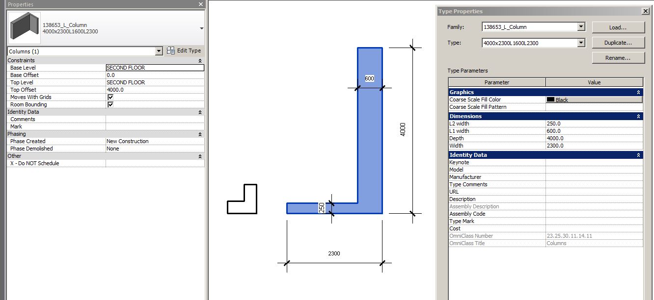

Sorry I posted the last replay before reading yours. Here is the family and thanks for your help.

Your family behaves exactly as it is designed.  Open your family and create the types there and watch what happens.  If you starte with your default type which is a backwards 'L', then add a new type and change Width to 250, the shape becomes an upside down and backwards 'L'.  Your geometry flops because the reference planes bypass each other.  I think your naming convention may be confusing you so create your types in the family.

Something is wrong with what you say is in your model.   The dimensions of the type do not match your name.
Look at the attached.  The family works correctly.  Recheck your work.

There is nothing wrong with this family it works fine.  You are doign something wrong.  The name of your family does not matter.  Click on the family and then edit type and change the dimensions to match your family name.  If you want a new one then duplicate the family>change the name>and change the dimensions under edit type.
