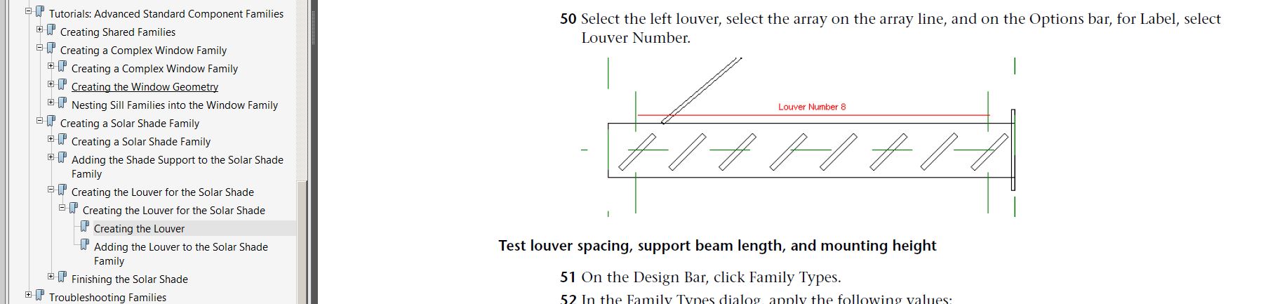

This would be created just like a louver.   The old 2010 "families guide' that can be downloaded from the autodesk site shows how to nest a louver type family into another family.
