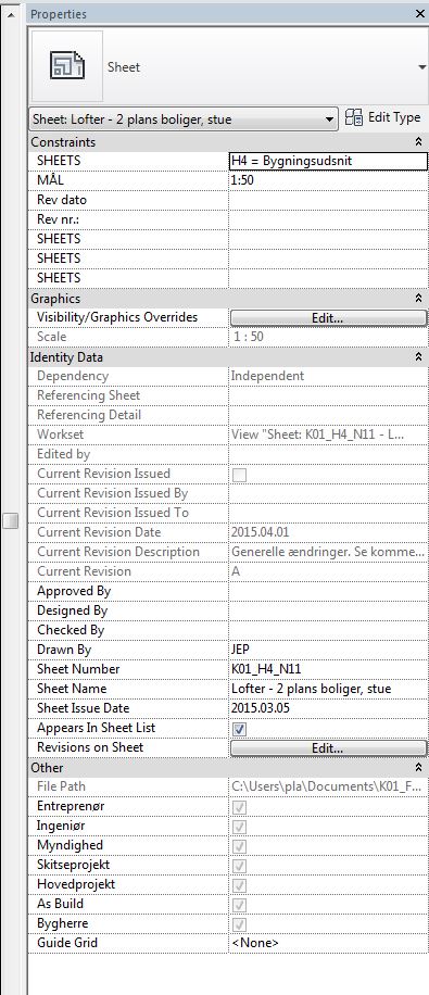

We see several folders / subfolders in the browser organization will be copied. This is totally uncontrolled and which seem rather random.Is there anyone who has experienced the same problem?
Wed, Apr 15, 2015 at 7:37:30 AM | Problem in browser organization
Do you have some apps that might do this?
View templates can assign folder placement of the view.  Look at all your view templates.
