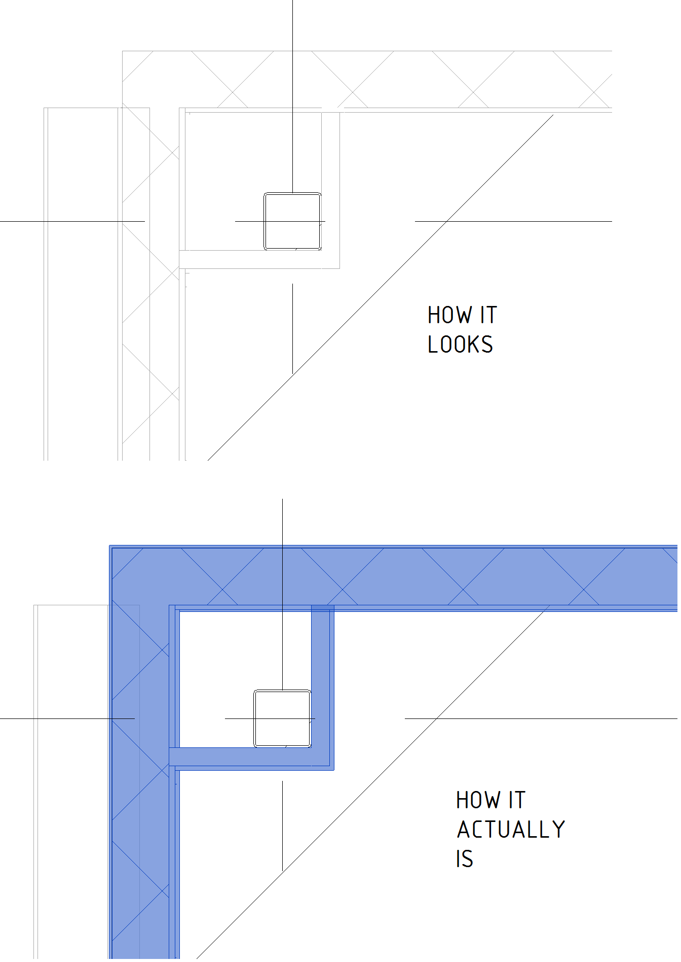

Well I'm not quite sure I understand you. Are you implying that the cut line style option applies only for the outmost line of the wall?
Here's a picture of what I have managed so far:

Tue, Apr 14, 2015 at 8:32:04 AM | Cut Line Styles not afecting some layers in walls
I can't recall seeing this work but maybe it does.
So on this image, where is the problem.  It appears that what looks like a 5/8" layer is gone from all of these walls.

Well you see, I want to disappear the layer next to the hatched one too, because that's the metal stud, and I want only the block wall to be shown. This metal stud layer is outside of the core boundary, it has the finish function, and it is still showing.
Any ideas?

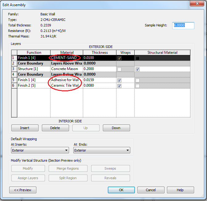

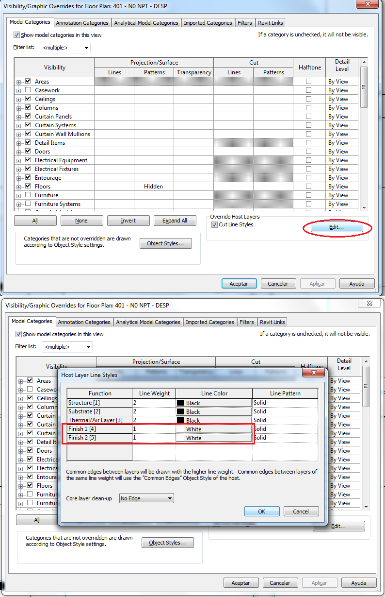

Ok, let me explain thouroughly what I did...
In the first image, I show the structure of one of my walls. In this case, I set the cement, the adhesive and the ceramic tile with the "finish" function.
Now, there is an option in visibility graphics override tab where you can change the line properties of each layer of the walls. This option you can fin it in Visibility graphics-Model categories-Override Host Layers (bottom-right corner). There, you check the "Cut Line Styles" box, and select the "Edit button shown in the second image.
A new tab will appear, and here I just changed the line color of the finishes of the walls to be white, so that it can be partially hidden in my plans. Nevertheless, the adhesive layer is still showing, even though it is set with a "finish" function, and that's the problem.
Tue, Apr 14, 2015 at 10:51:07 AM | Cut Line Styles not afecting some layers in walls
It appears that your process is defeated because of Revit's rule show in the 'Host Layer Line Styles' where it says "Common edges between layers will be drawn with the higher lineweight.   Common edges.....will use the "Common Edges" object style of the host".  and that is black lines.   If you change this to white, you lose all of the common wall lines including your core.
