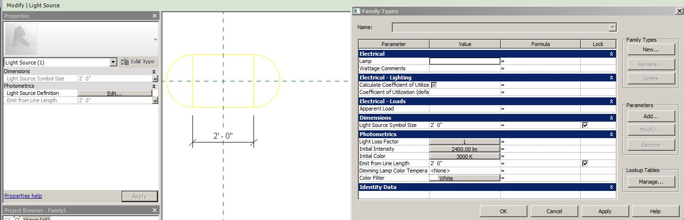

From your HELP, read this and look at the 2' dimension in the image below.

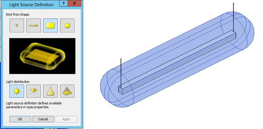

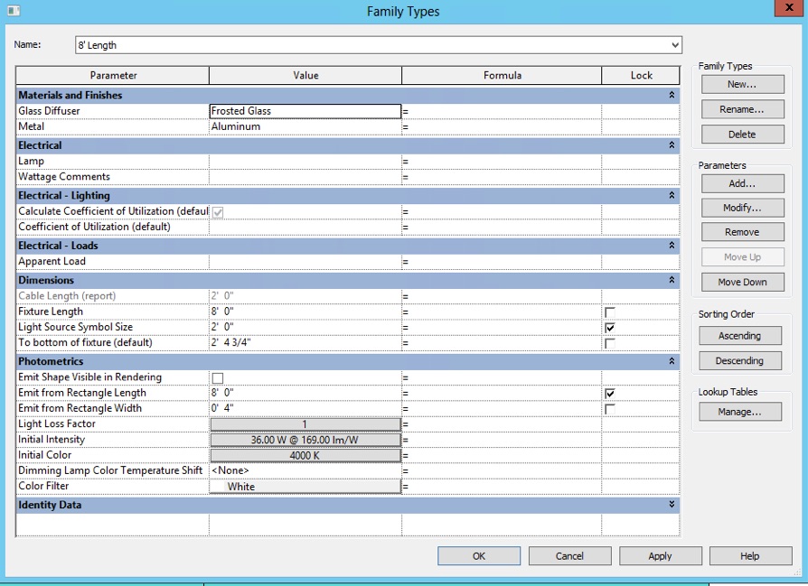

Thanks, WWHub. I've already done that based on all the other lighting threads on here (and other forums). I'm attaching a screen shot of my 8' type properties...the emit from length changes with each type. Yet, it's not stretching to that length. I'm also attaching a screen shot of my light source definition. I believe this is the best choice for what I want and it seems to be almost there, aside from not actually stretching with the length of the fixture.
What am I missing?? I feel like I'm in line with the link and image you provided...so stumped. Thanks in advance.

Back when Accurender was packaged as part of Revit, lighting worked very well.  I have never liked how it works now and in this case, I can't  get it to work correctly either.   I did get the symbol length to change by setting it = to the emit line length but it renders as a spot.
My test was 2014

To anyone looking at this with a similar issue, I did start playing with the light loss factor. I increased the number with the longer types (in my case, LLF 1 for the 4'; LLF 2 for the 8' and LLF 3 for the 12'). It's still far from perfect, but it's certainly an improvement.
