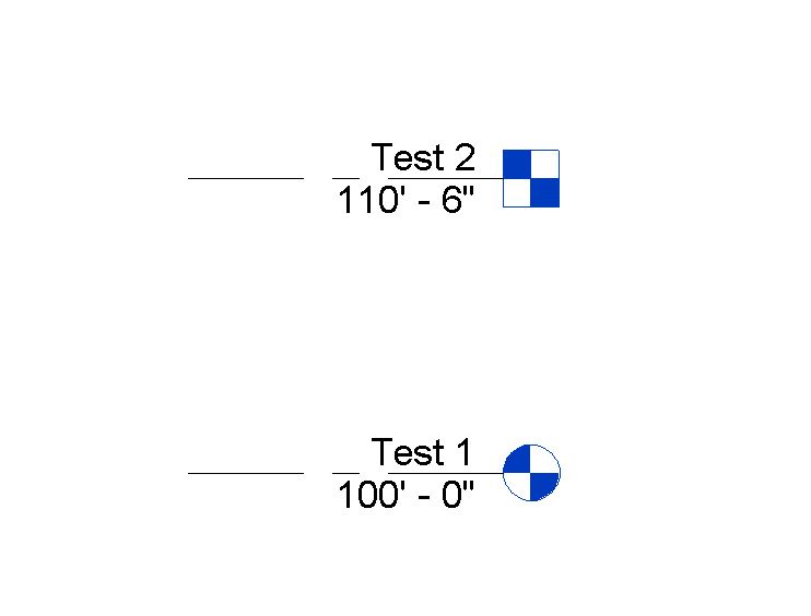

Is it possible to have 2 or more different level marks in 1 Revit Project file, but, of course, on 2 different views.  I have my default Elevation Datum Marker for my exterior elevations.  I want a different symbol of Level Marker for my interior elevations.  If I change my Level Marker on my interior elevation, my Elevation Datum Marker on my exterior elevation changes too.  How can I make to independent Level Markers?

Click on your elevation>Edit Type>Duplicate and change the Symbol to what you want to use.

Sorry, but I did that already and the result is both my Exterior & Interior level marks change to any symbol I choose. Or is there something I'm missing here?

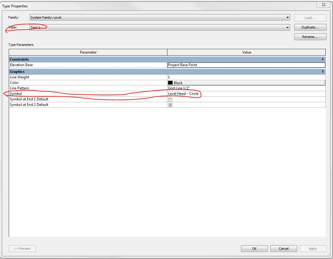

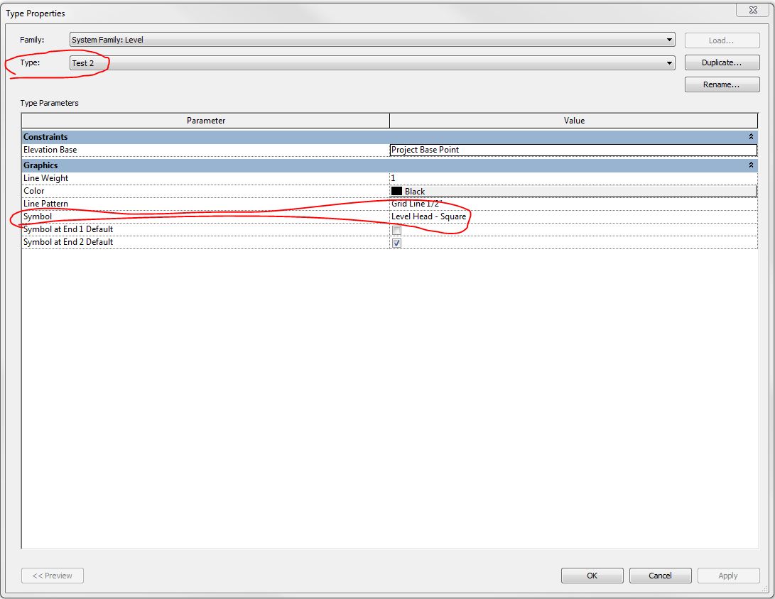

You are still doing something wrong then.  Interior and Exterior do not matter, they both use Levels.  You just need to duplicate the type and change the symbol of one of them.  See my attached images.  If this doens't work you will need to attach some images of your process and problem.
