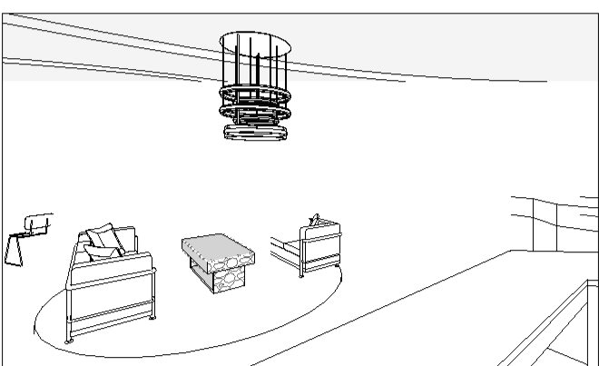

When I use the camera tool to get a view of a space I have created, quite often it appears with big blank sections. Does anyone know how to fix this? As you can see in the picture, it appears as though there's a big white box right in the middle that is cutting through my couch and hiding everything behind it.

Camera views have view ranges just like sections and elevations- you need to adjust that and set how far you want to see.
