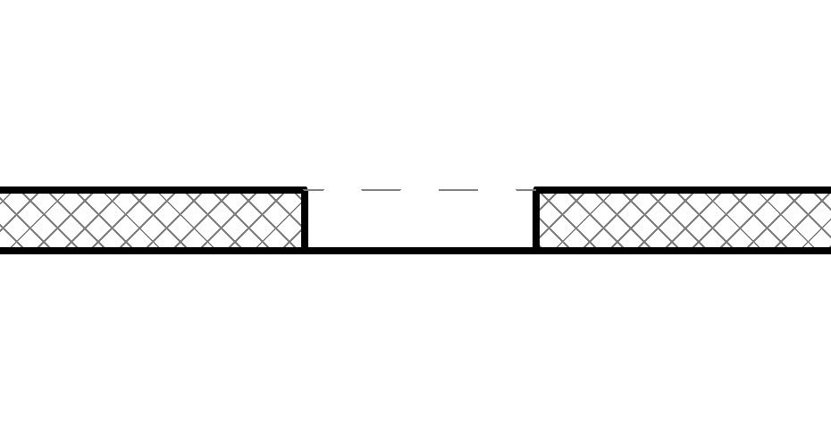

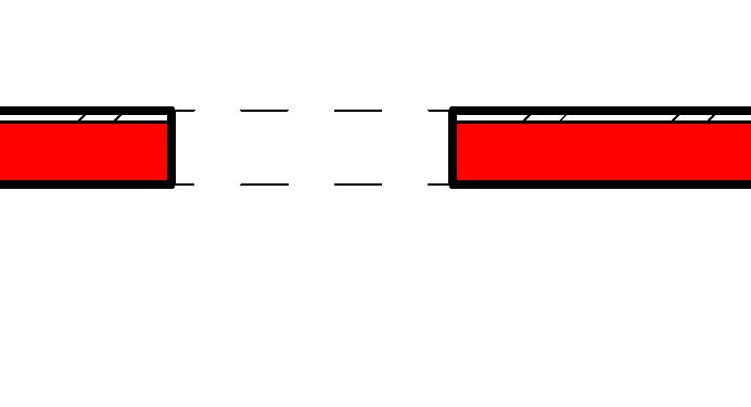

I have a door family I created to just be an opening with trim.  It looks great when its a new door in a new wall but once I do an existing door in an existing wall I get a really dark line one one side.  It looks like the opening lines from the family are coming through but I don't know how to shut them off.  Anyone ever have this problem?

In your family (plan view), dashed symbolic lines are different. One is hidden (cut) and the other is hidden (projection). Make them both the same. Opening object has nothing to do with it – it’s always invisible.

Wow how did I not see that one???  Thanks a lot
