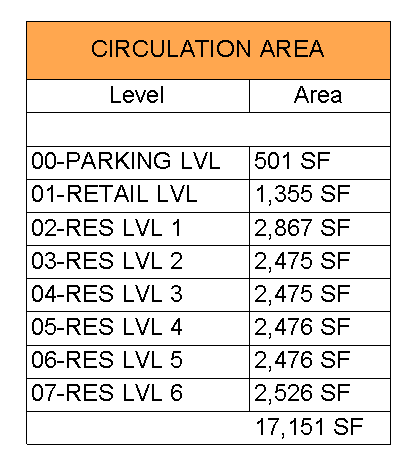

attached is the way the room schedules look. I have a schedule for each department like this. Circulation works well because there are rooms on every floor, but the rest of the departments do not have rooms on every floor and consequently won't show in the schedule.

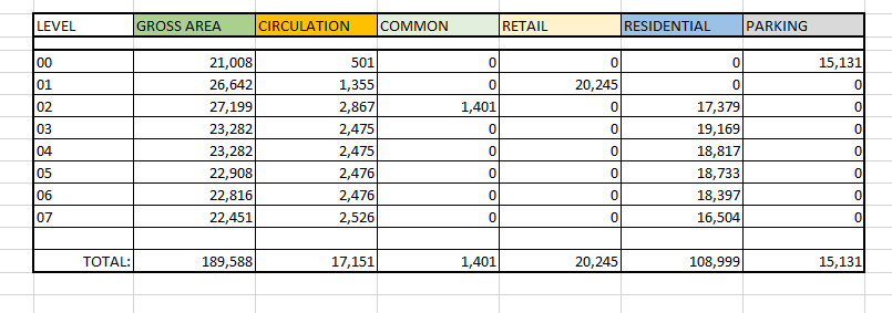

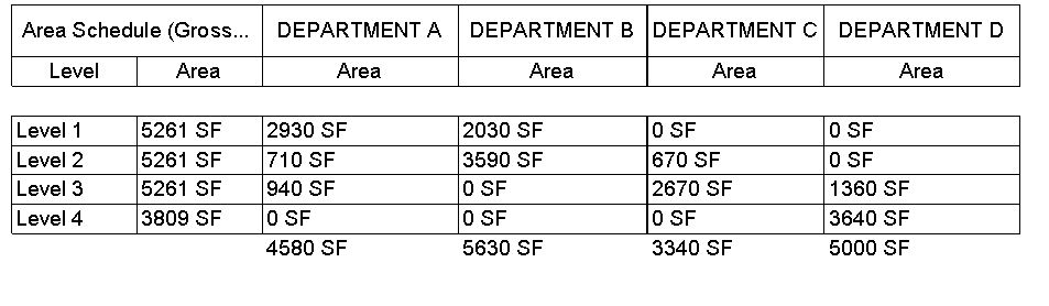

I guess yesterday killed off more brain cells than I anticipated. Since pictures are worth 1000 words, please see attached lol.
The sheet I have in the model now is "Revit Schedules.png" which shows the areas. I'm trying to get "Revit Schedules - Hopefully.png" to look like "Excel Chart.png". The "Revit Schedules - Hopefully.png" is a copy of "Revit Schedules.png" without levels shown (which may look confusing now). I've decided to manually input the numbers into excel because I have multiple schedules going at once, but I do know you can export from Revit to excel, thanks for the heads up though. (and we can't afford any 3rd party plugin to link excel and revit schedules)
Hopefully this really clarifies my question. I'm just trying to keep everything in Revit reducing extra (and hopefully unnecessary) steps. If you think that using area plans/schedules would be easier than room schedules to accomplish this, then I am all ears.

Wed, Mar 18, 2015 at 1:54:34 PM | Room Schedule showing all levels?
#9
I hate it when we are stuck with a visual process based on "How we do it".  That being said - you laid down the gauntlet.  Do you want it like this?
Extra 0 sf rooms can be filtered out of normal schedules.

WWHub, you are a life saver, thank you very much. I also am personally not a fan of workarounds to fulfil the "this is how we do it" approach, but alas I don't sign my paycheck. Thank you again.
Thu, Mar 19, 2015 at 4:13:22 PM | Room Schedule showing all levels?
#11
Glad to be a help.  A good challege like yours helps all of us.
I just have to add that those extra 0 sf rooms should be put in a design option so they don't interfere with anything.  Have the base design option have nothing and add these to the second option in that set then filter these schedules to include the DO.
