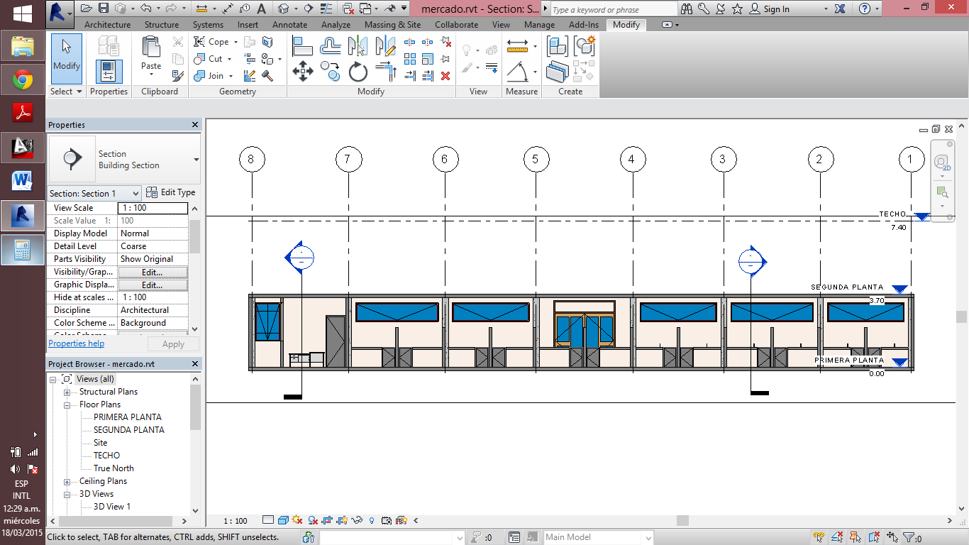

When I go section view, doors and windows don't look too realistic, they have those triangles unlike in 3D views, where everything looks fine. Any tips on what to do with doors and windows in section view? Thanks in advance

Oh by the way, I use revit 2014

Type VV to open visibility graphic window, expand window and door category by clicking on the + sign, and uncheck elevation swing subcategories.
Depending on the family, sometimes changing display detail level will do the job as well.
