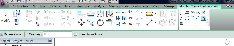

It's been a good few years since I've done any reviting and now that i'm working on a new project I'm coming across plenty of issues. I've been able to nut out most of them but now...
I'm stuck. When i try to create a roof i dont get the regular dialogue. First pic is what i would expect to see, second pic is what i'm getting. No idea what's going on so if someone would be able to help me out that would be great.
Thanks.

It’s a known issue in Revit 2013 due to .NET Framework 4.5. Install the latest update for your Revit version and flavor.

Just for future reference, when you post problems like this you should always tell us what revit year and update you are on.

Thanks for the help guys. I've updated to 2015 and sorted out the issue but now i'm on the hunt for some new hardware.
