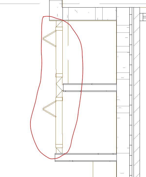

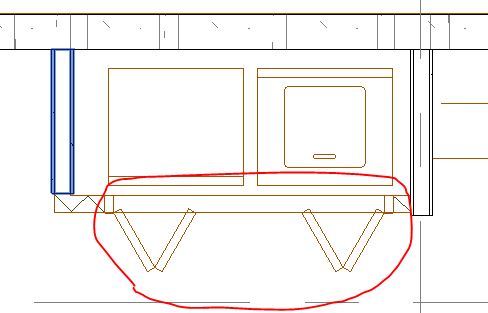

Wondering if anyone knows where to get a bifolding closet door... been looking for a while and can't seem to find one. I'm looking for single and double, I attached some pics as well. Thanks!
Tue, Jul 11, 2017 at 9:14:43 AM | Doors
#12
These doors are in the Revit library.
Anyone have pocket doors or pivot doors?
