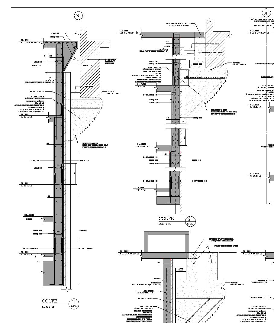

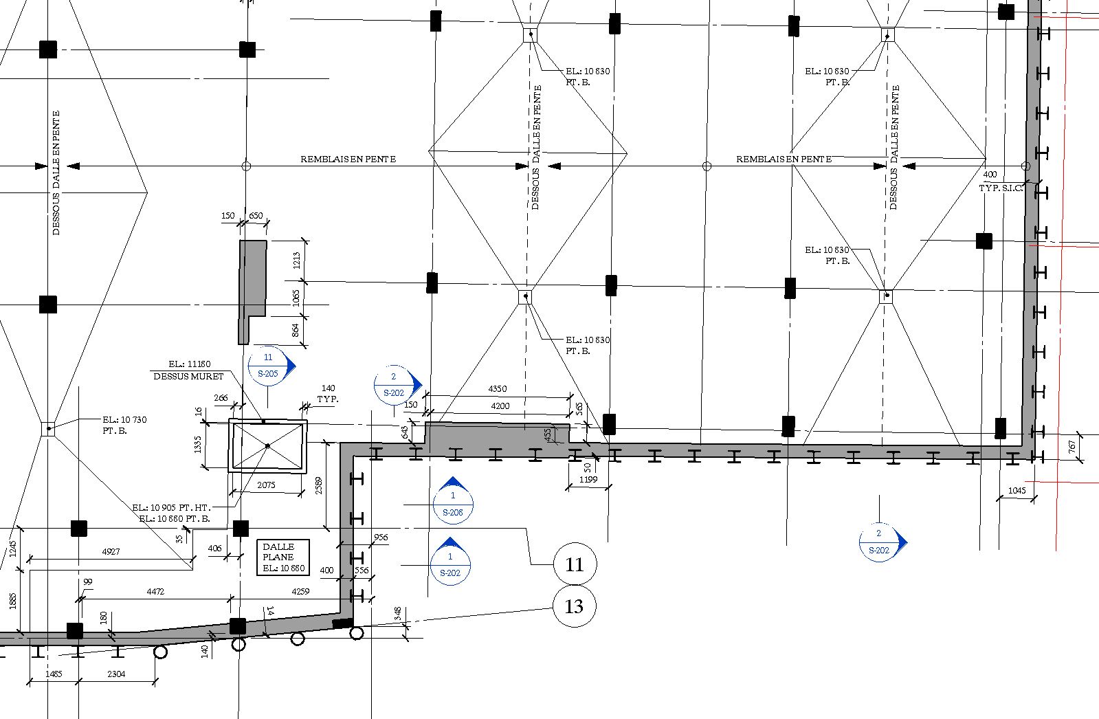

i have a floor plan with all my detail and annotations showed on it. (pdf 1)
i have multiple section on it too, and particully 2,  the 1/S202 and 2/S202 the are displayed on sheet S202 (pdf 2)

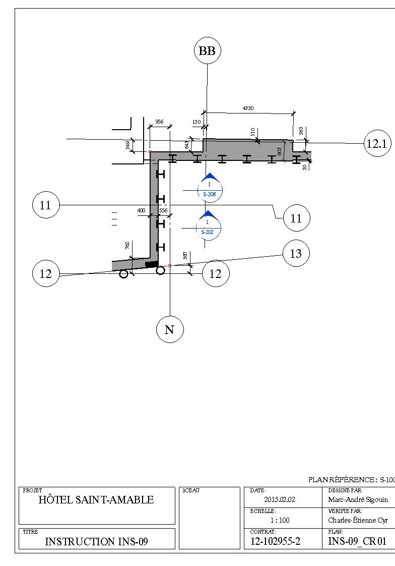

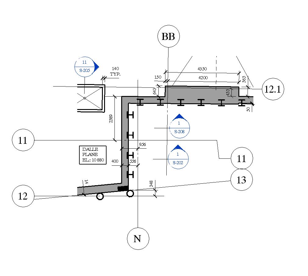

i had to do an instruction on a smaller sheet so i duplicated my floor plan (dependent) and crop it a little (pdf 3)
i put that dependent new view on a smaller sheet which is call INS-09_CR-01 (pdf 4)
since tha, now those 2 sections that where displayed on S202, are not named 1/S202 and 2/S202 anymore they changed to 1/INS-09_CR-01 and 2/INS-09_CR-01...
how can i let be named as they were before... ???
137802_pdf_1__floor_plan.JPG137802_pdf_2_sheet_24x36___202.JPG137802_pdf_3_floor_plan_dependent.JPG137802_pdf_4_instruction_sheet_with_dependent_new_view.JPG137802_pdf_5sheet_202_after_putting_the_dependent_view_on_sheet_INS-09CR-01.JPG
