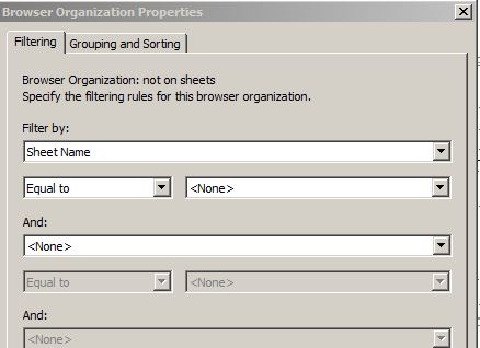

Revit makes whatever view you are in bold in the project browser. Wouldn't it be great if it would grey out the views that are already placed on sheets?
If this is already an option I cannot find it.

You can have multiple browser organizations.  We use 6 different ones including one that is not on sheets.

I was hoping that you can see what views you have remaining that are not placed on a sheet yet.
It seems as if you have to drag it onto a sheet to see if its part of your drawings or not.

Wow - Read my answer and look at the image!!!!
Then read this:
http://help.autodesk.com/view/RVT/2014/ENU/?guid=GUID-431A677A-C2D8-49D0-B6CD-0BA3B4A2DD71
