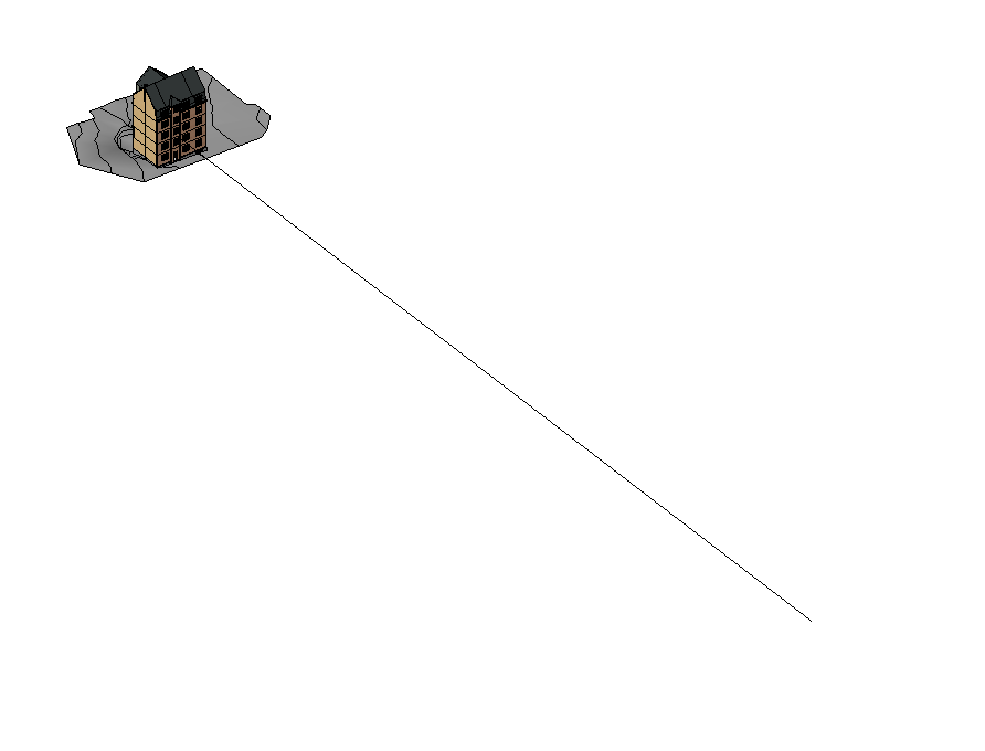

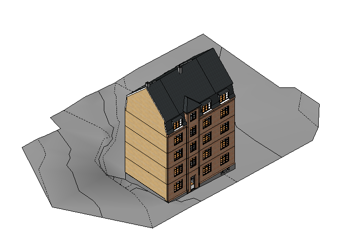

I've build a model in exisisting construction, demolished some of it and then rebuild a new area. After that i made ventilation on one floor and i dont know at what point, but now i got a lone line from the middle og my building stretching way out. I cant remove or delete it, i cant even select it. I have tryed to select the whole building but nothing seems to help. The line is also only shown in new construction phases.
I'm using Revit 2014
Anyone seen this problem before?

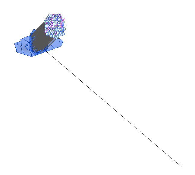

Do you have anything linked into your project?  If so is it part of the link? Can you do a save-as and purge your project and ease everything but the line and upload it here so we can take a look
Tue, Mar 10, 2015 at 7:23:27 AM | Long line in project
Did you audit the file?   That should be your first step.
Then I would use a bubble sort to try and identify what may be causing this.  Delete half the elements and see if it goes away.  If it doesn't, then delete half of what's left....continue until you isolate the problem to a group that you can then work with using the same process.

I have tryed toaudit the file and purged all the unused, didnt help.
I havnt linked anything into my project yet, but now i made a seperate file, deleted everything and then purged it.
The file is linked to this post.

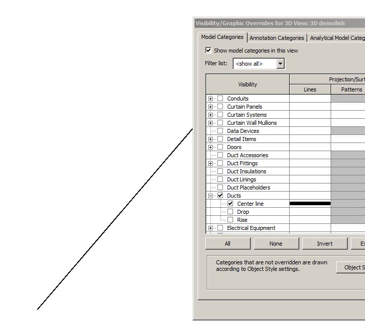

I'll tri again, i can see now that the line is somehow depending on the 04 1 sal level
But still cant figure how to remove it without deleting the entire level. A little progress atleast.
Thanks.
Wed, Mar 11, 2015 at 7:39:20 AM | Long line in project
#9
It seems to be a supply duct.  There was one element in the project but when I deleted that, the line still did not go away.   You can turn that category on/off but the file must be corrupted.
