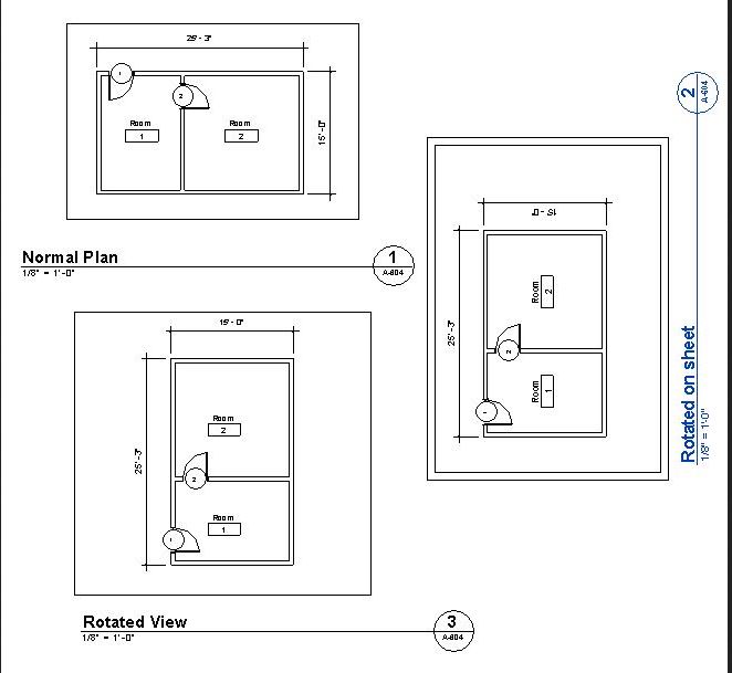

Fri, Mar 6, 2015 at 12:14:14 PM | rotating spot elevations on plan
Perhaps you don't understand option 2.  This does not rotate the model elements in the Revit 'world'.  It only rotates the elements as shown in that view and only that view.  This is especially helpful with say a rectangular callout of bathrooms that will work better turned 90 degress from what they were in the floor plan.  Or say you have an angled wing on your building that at a larger scale will not fit on your sheet but when rotated to be parallel with the sheet it will.
TRY out this process!  It will not affect your real model in any way.  You can have multiple views of the model with each one turned at a different angle.
Look at the attached.   Copied with detailing plan views.... All the same model and on the same sheet.
