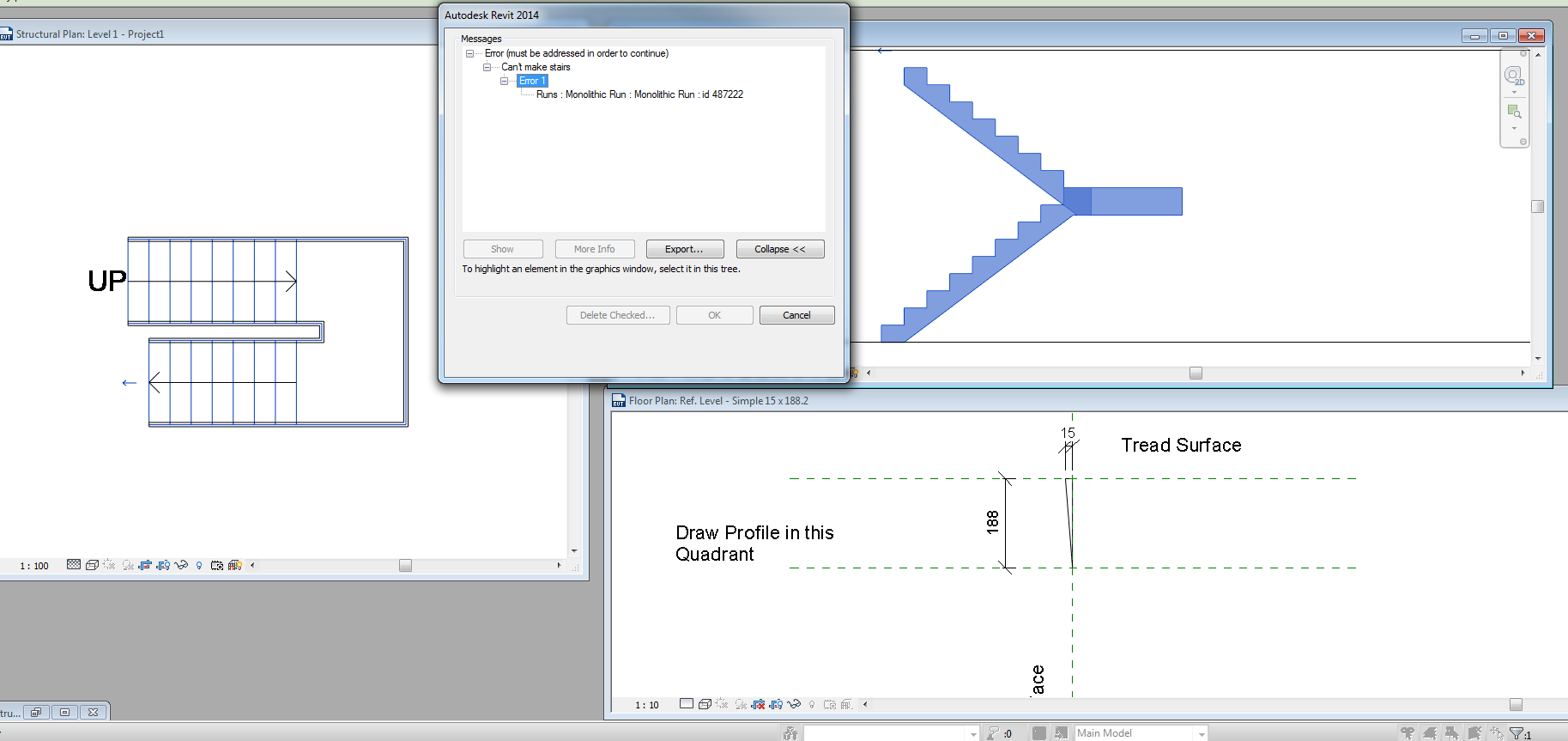

Hey,
Trying to add a simple stair nosing profile to a stair. 15mm x (Riser height 188.2mm)
When i try applying it i get error "can't make stair"
Runs: Monolithic Run : id 487222
It's a cast in place stair, Profile i drew to the size required for this stair. Can it be more generic so i can use the same profile on other stair's that are different to 188.2?
Thanks
Rob

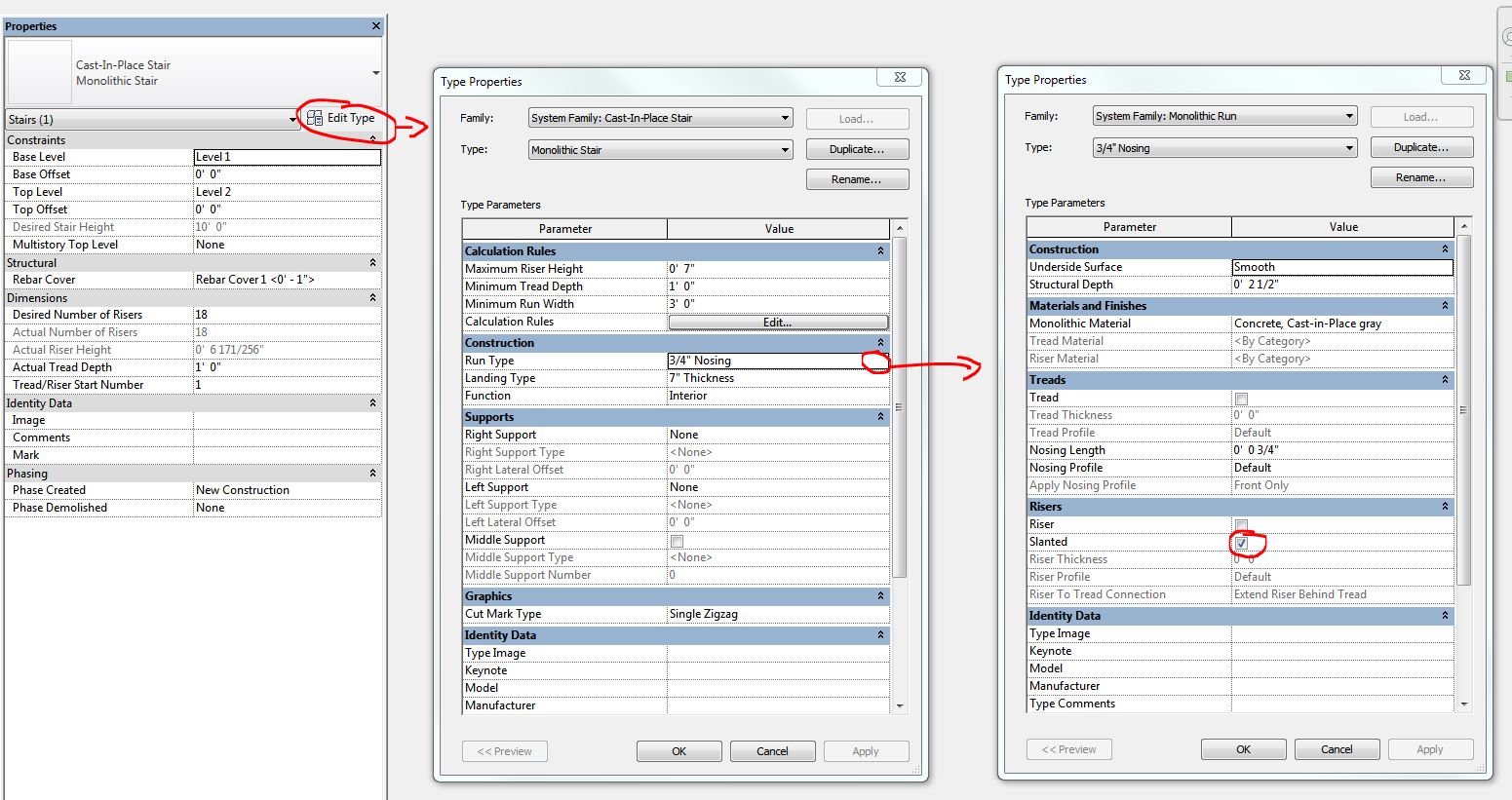

Are you trying to create slanted risers? Why not just tick ‘slanted’ option in stair type properties, instead of applying this profile to the riser?

Thu, Mar 5, 2015 at 8:21:13 PM | Simple Stair Nosing error
pijpiwo
pijpiwo Avatar
Joined: Fri, Sep 3, 2010
0 Posts
5 Stars: 25 Votes
See picture.
Thu, Mar 5, 2015 at 9:15:24 PM | Simple Stair Nosing error
spinxy
Joined: Mon, Aug 11, 2014
0 Posts
Thanks for the Picture, as soon as you mentioned the slanted tick box i found it.
Thanks
