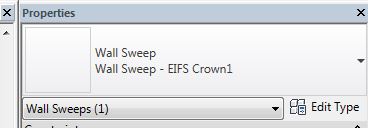

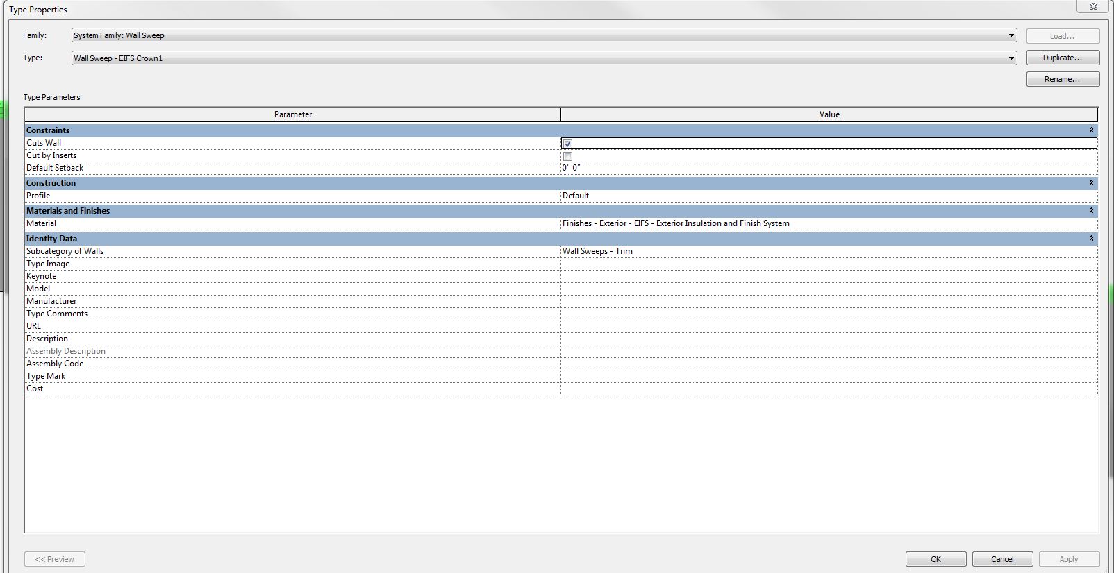

Ok maybe its because its Friday but I cannot figure this out!  I have a wall sweep type called Wall Sweep - EIFS Crown 1.  It is in my template file and I want to delete it out because it is garbage but for the life of me I cannot figure out where to do this from.  I attached images of the properties if it helps.

When you start a project, there are several system level items that are defaulted in Revit just to give you something to start with.  You can never delete these fundamental elements but you can rename them and redefine them.  This may be that original type.
So you can edit this one to what you want to keep and delete the other types.

Good idea to just rename it to use with something else. not sure how I didn't think of that.. still going to blame it on Friday brain.
And I had to go into Purge to get rid of the types that I made myself.  Thanks!
