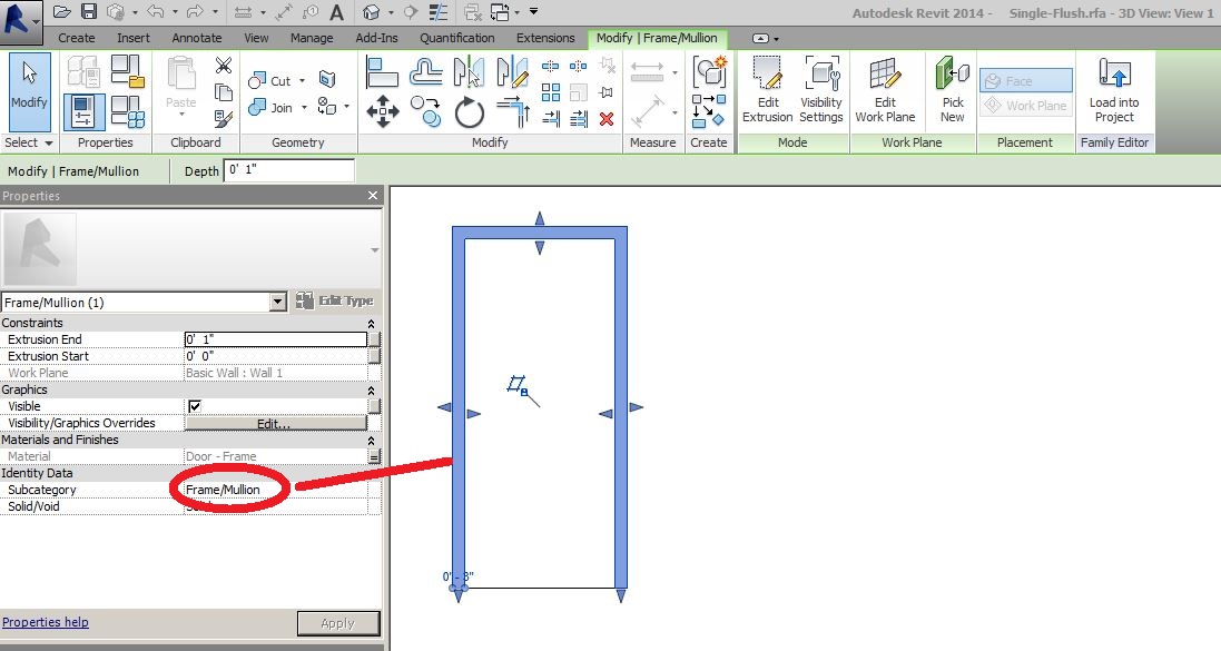

We schedule the frame as a door property rather than a seperate schedule.  If the door family is built correctly, the frame geometry can be isolated in a legend component.

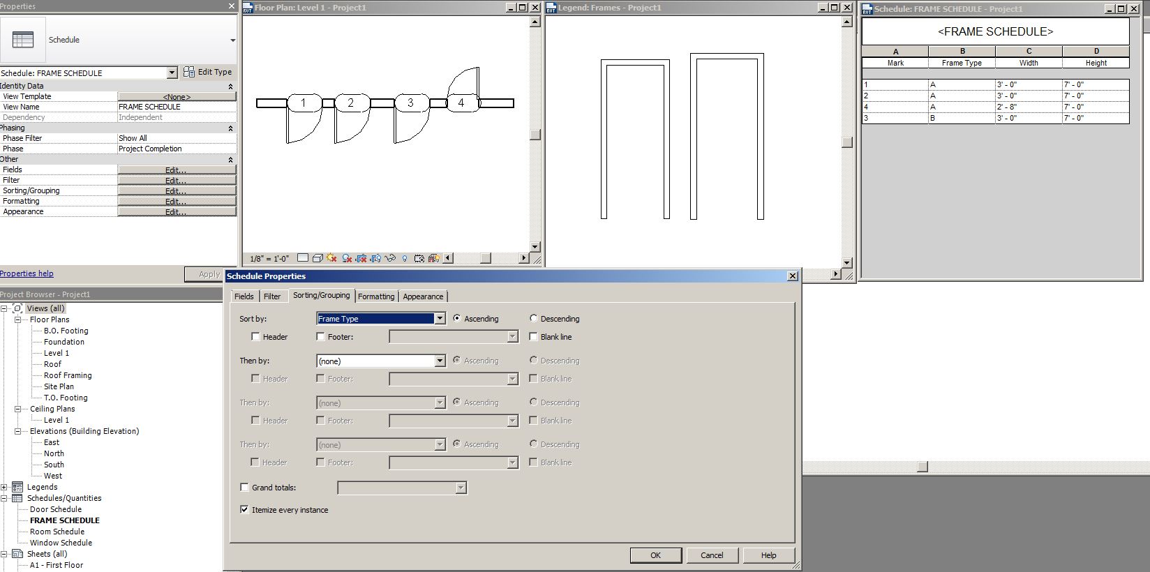

If you build frames seperately from doors and use the door template you may wind up with a mess because they schedule as doors.  Take a look at the image below using a stock door.  It schedules the frames using a door schedule.  Look at the legend too.

I tried to make a door schedule, just renaming it as a Frame schedule. Do you think it could work?
I'll try to convince the company one more time.
Much obliged!
Fri, Feb 20, 2015 at 8:02:03 AM | scheduling frames
Absolutly it will work.

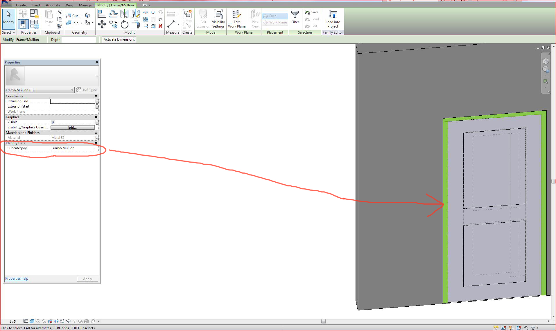

You don't say - are the frames a nested family?   I would not do that because I don't see a need.
I don't like to use the term mass unless it is a mass.  Mass is a category.   Take a look at the stock windows.   The fame is either a sweep or extrusions (not a mass) in the frame category.  That is what I mean by being built correctly.
Because the frame is in the correct category, it can be contolled seperately in the project VG settings.  The frame legend component I show in my earlier post is not a seperate legend component.   It is the door.... with the door panel, swing etc turned off in VG and just the frame showing.  And the schedule is a door schedule but shows the frame parameters along with the necessary door parameters.  If you have your frames in a seperate family and are scheduling that, then that is the hard way to do this.

So, I see that I am on the right track. I make the frames as a sweep or extrusion. I use door schedule for frames. i guess i understand that your image is the image of the doors with turned off door panels.

I don't think you hear yet what I am saying.   The frame is created in the same family as the door.  Please spend some time looking at how the stock doors are done and the attached image.

Thanks a lot, WWHub.
Your final image was critical. It helped me with this small hindrance - assigning a subcategory.  Everything works well.

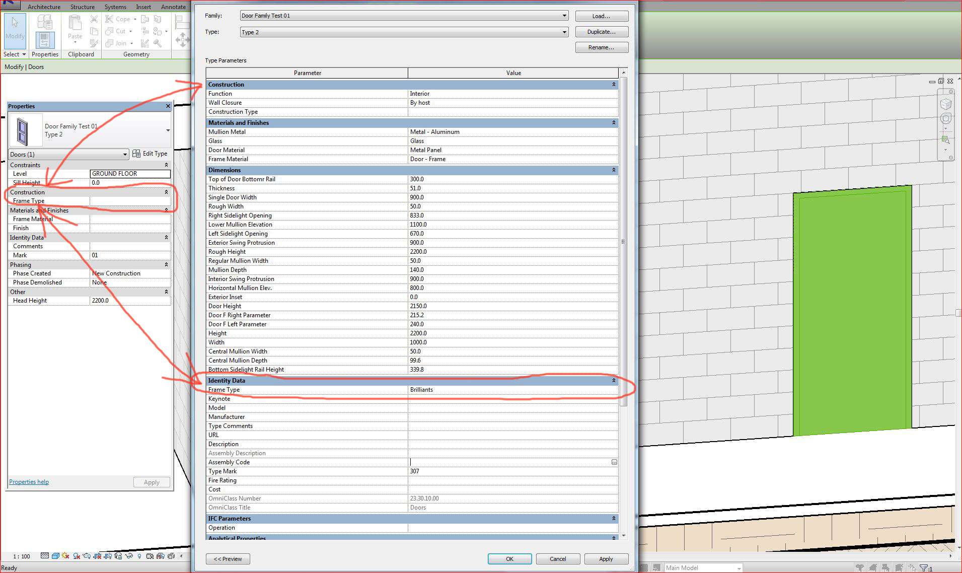

Just in the Item parameters the Frame type is under "Construction" section and does not show anything. Why it is so?

Because you used the wrong template.  You have not told us anything about your process.
I don't know what you mean by: "... the Frame type is under "Construction" section...".   The image I give is in the family editor - not the project.   Please post your family because we can't go any furthur by guessing.

Thank you for the reply.
I understand that it is a family on your image. I I don't understand how you made it working in schedules.
I am placing mt family. Is the resolution good enough?

Please post this door family!

Please see the attached.
I think now it works somehow, but i am not sure if I did it correctly.
