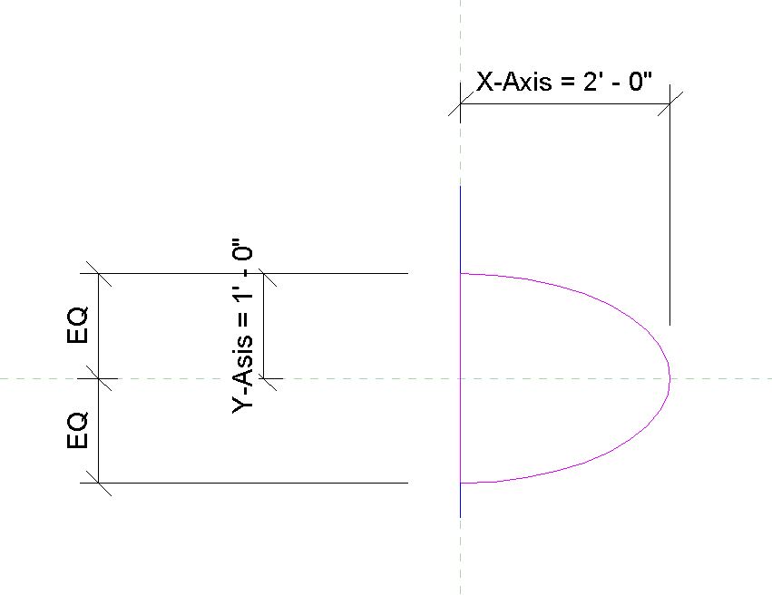

Hi again,
All failed? Well The EQ and the X dimension worked perfectly fine. It was just the Y dimension I found to be the one refusing to behave. I'm assuming the family i attached previously worked fine for you?
Well the only thing i can think of is the reference line itself was the item/object being moved by the value change in the Y dimension. Again, not sure you managed it if this was the case Smile
Well, I'd imagine my dimensions are no different to yours. But sure, I'll explain what I do.
  1. EQ dimension, create the dimension by selecting the blue point on the ends of the curve and then select the reference line as the centre.
  2. X & Y dimensions, select the reference line and then the point you wish to associate it with. Again, looking for the blue dots.
Parameter wise, nothing different. I typically make the parameter through the dimension itself by selecting the label and Add Parameter. But you can make it before hand. However, doing it this way means the dimension current value is automatically inputted as the "Value" field.
In terms of your issue here, its hard to advise in regards to trouble shooting. I find it is always best to narrow the problem down, typically trial and error so delete one dimension and try the others and so on.
The nice thing about Revit is there are frequently a few ways to achieve the same thing. So, for example, instead of having the EQ dimension you could create another dimension and label it the same as the other. See attached image.
Hope that helps.
