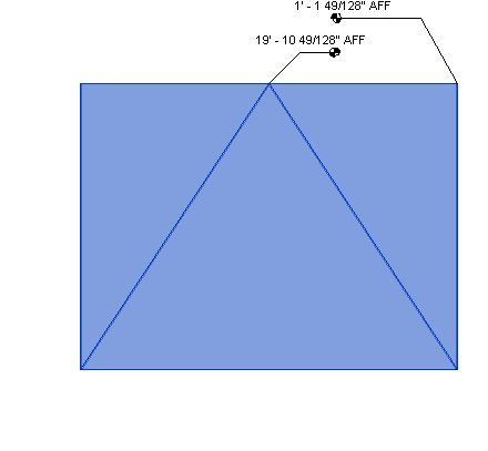

Don't split the roof, use the define slope.  I konw, it doesn't make a pyramid - right?  Like the first image below in this 9/12 roof.  Here is the solution.

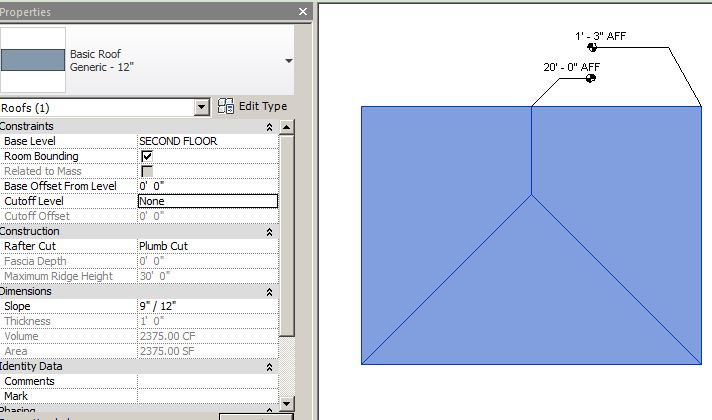

  1. Determine the overall height you want at the peak - image 2 (I used point elevations) - In this case, I will hold the 9/12 for the sides and modify the front slope to less slope which will be 18'-9" in 38' - 0".
  2. Also image 2 - Enter the slope for the front roof element by using a formula.   (((GREAT TIP - YOU CAN USE A FORMULA ANYWHERE REVIT WANTS A DIMENTION!))))
Done
You use a similar process if you want to hold the front slope.   Just calculate or build the roof as a single front slope only then find out how high it is.

I should have included the dimensions.  This square is 38' deep so the number is correct.  I changed the front slope.   The side slopes would be 1/2 the width wich was 50'.   Just a stupid quick test roof to show this.

The front edge defines the slope of 18'-9" in the depth of 38'.
The side edges define the slope that is 18'-9" in 1/2 the width of 50' = 25'  (( Checks - 9 / 12 ... 9"x25 = 225" = 18'-9"))
