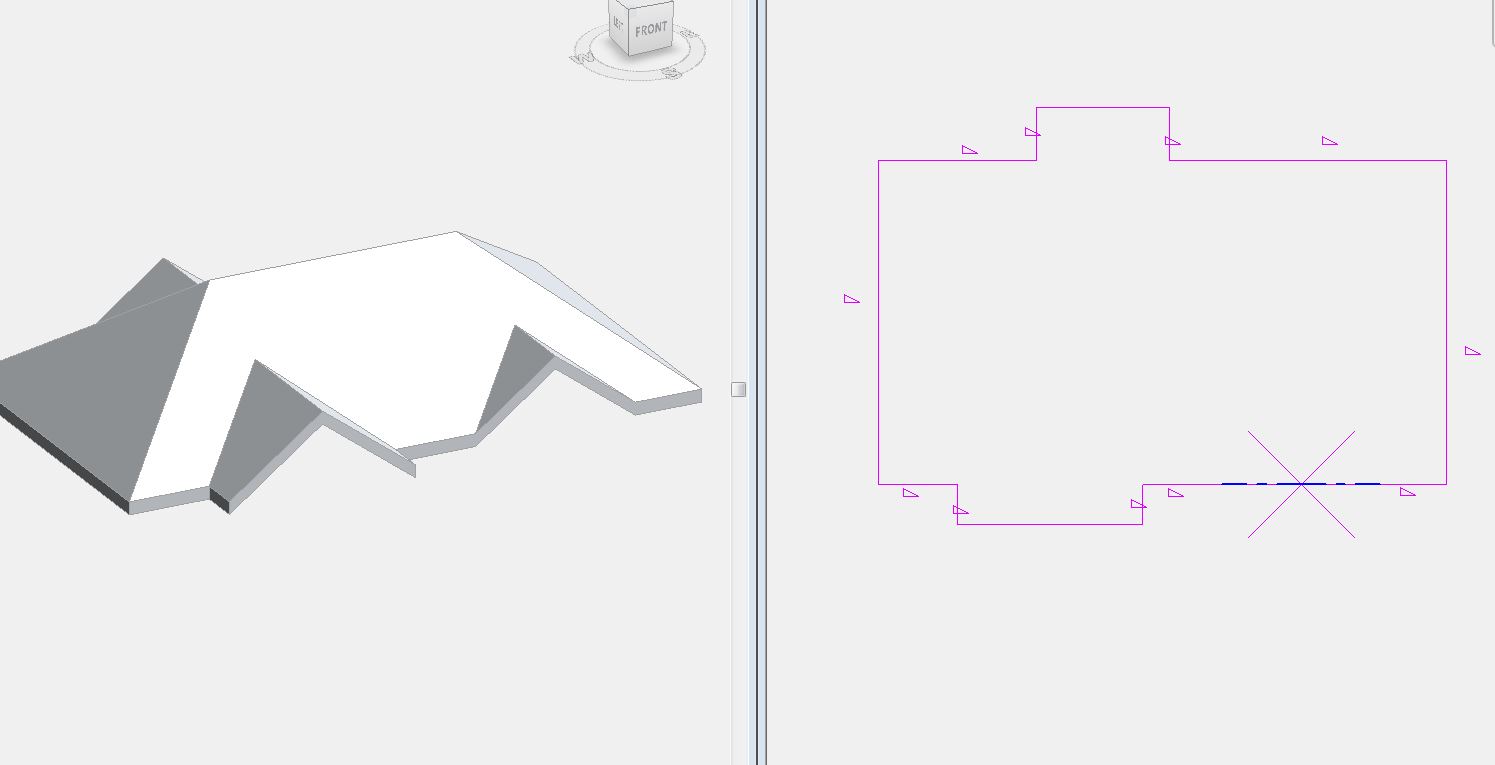

Is there a way to add a gable along a straight roofline? In other words, I want to simulate a gable without moving any walls to create the offsets you would normally have with a true gable. I haven't been able to find a way to make it work on Revit. I can make it happen when I frame the structure, but I don't know how to make it work in the program.
I used the "roof by extrusion" to create the look, but there are several problems:
I can't join the roofs
I cant flush the front of the gable with the existing hip
Untitled.pngEdited on: Sat, Feb 7, 2015 at 5:11:39 PM

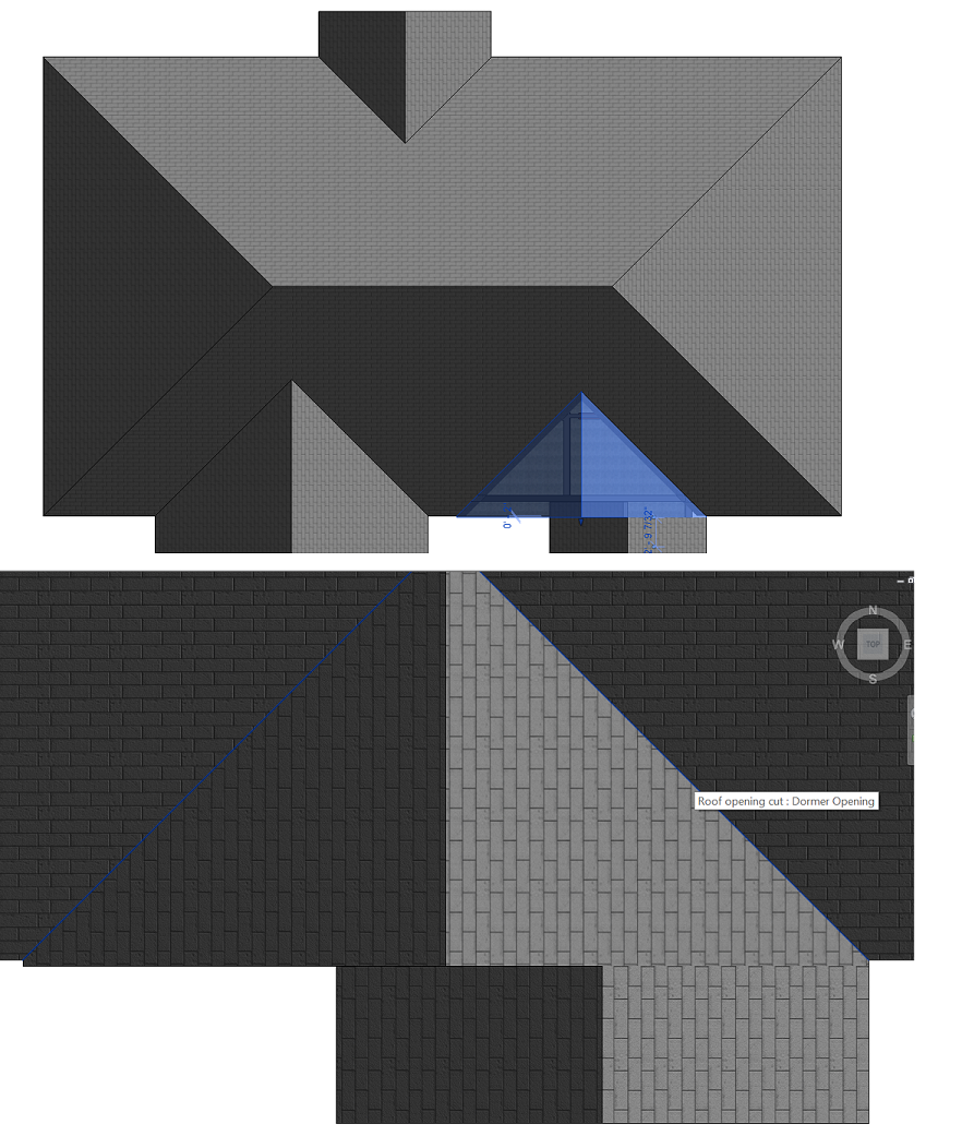

Use slope arrows.

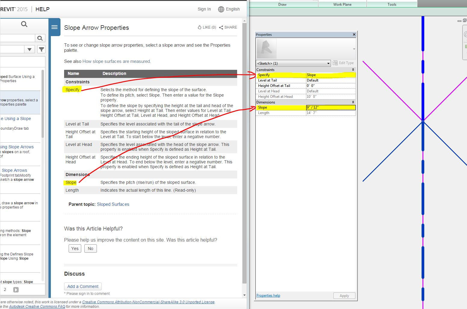

I got it to work, but how do you adjust the slope? I need to join to another roof and I am having trouble getting the pitch to match.

See the picture and this link.

Well that was easy too. Thanks so much for the help!
