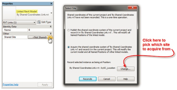

Revit cannot acquire shared coordinates from a model with multiple Site definitions when using the Acquire Coordinates tool.
This seems to be a limitation of the UI that should be addressed. You can acquire coordinates from links with multiple named locations by clicking on the Shared Site button in the link's instance properties.

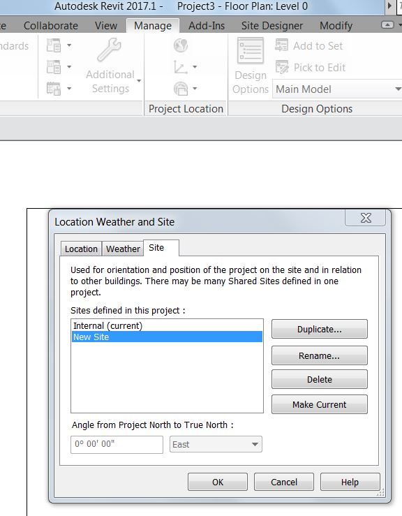

I've come across this same problem today and manage to ascertain which sites it refers to. I did not find any other information online so hopefully this will help future users.
Under the Manage tab select Project Location and then Location. Select Site from the dialogue box and you'll notice that there are more than one "sites defined in this project". I deleted the ones which were not relevant and left only the current site. I then proceeded to Publish Coordinates in the regular way.
