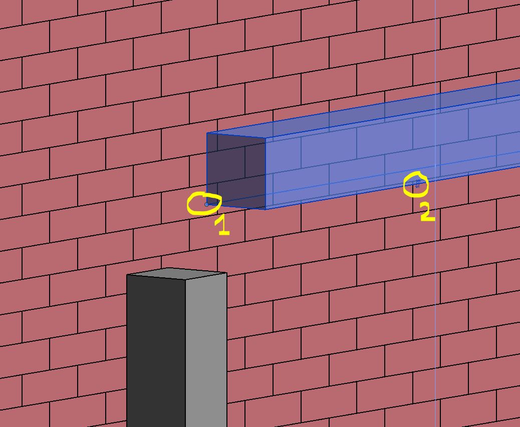

I would like ot mitre wall sweeps (trim around windows). it does not happen all the imtime. Can anyone tell me how to go about this? Thank you in advance.

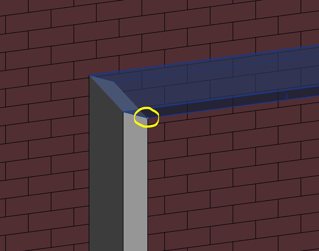

Drag the blue dots (1) of both sweeps so they are at the same spot, on top of each other. If one sweep has a dot on a different plane than the other one, use flip arrow (2) to bring both dots to the same plane.
For the window/door trim however, I would recommend using an extrusion or a sweep in the window/door family, not wall sweeps in the project.
